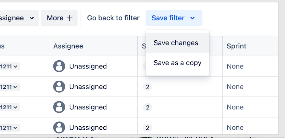

Hi @Larry Wood
Once you update the JQL expression in your filter, you need to run the search. Then Save it using the Save option on the far right. (Only filter owners can save it).
Once you save it, you should see the new project name every time you return to the filter. Have you done these steps already?

Larry Wood
June 13, 2025
Thank you for guidance.  The answer was correct and helpful.  I also found that when copying and altering a filter, it is helpful to remove all parameter values from parameters whose values may be illegitimate for other parameter settings, so that JIRA doesn't kick into JQL mode.
