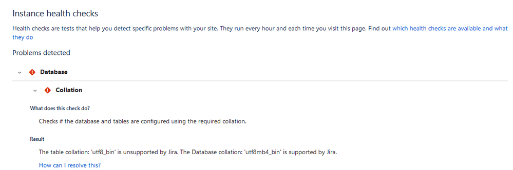

I've set my database collation to utf8mb4_bin which is supported by the latest version of JIRA:2020-09-21_16-35-46.pngbut I still can't pass the health check:
2020-09-21_16-36-27.pngWhat might be the problem here?
Nic Brough -Adaptavist-
September 21, 2020
The database does not appear to be set to utf8mb4_bin - in the result line, it is reporting what the database has told it the collation on the Jira database is.
You'll need to change the collation of the data, as well as the database setting.

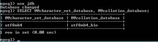

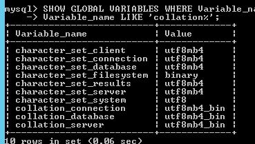

@Nic Brough -Adaptavist- I created my new database like this:
CREATE DATABASE <dbname> CHARACTER SET utf8mb4 COLLATE utf8mb4_bin
and then I used mysqldump to transfer the old database to the new one.
Here's the screenshot:
As you can see everything is set correctly.
September 22, 2020

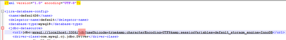

I assumed you did, but we need to find out why your database is telling Jira that it is utf8 rather than utf8mb4.  Are you sure Jira is looking at the right database?
JConstantine
September 23, 2020

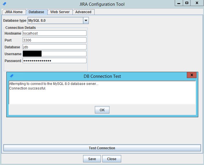

Yes. I'm sure. Here are the screenshots of Jira Configuration Tool and dbconfig.xml file:
September 23, 2020

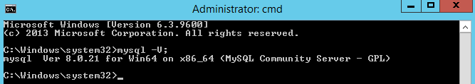

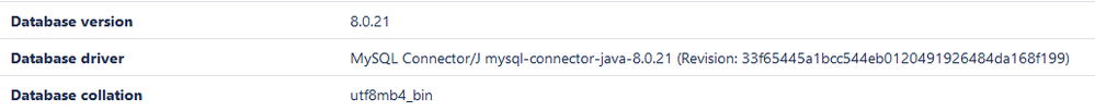

There's one last long-shot - could you
  • Tell us what version of Jira it is (you mentioned 8.6 earlier, but I suspect you're now higher than that?)
  • Tell us what the database version is (not via Jira, but directly on the database command line (don't trust everything Jira is telling you!)
  • Confirm you're running everything on one single machine - Jira, the database service, the mysql command line that you've used to show us stuff and the jira config tool
  • Check the database driver file - what version did you download and add to the jira directory?  (Again, don't trust Jira to tell you)
JConstantine
September 24, 2020
  • Jira Core 8.12.2, Jira Software 8.12.2, Jira Service Desk 4.12.2
  • Everything is running on a single machine
  • I downloaded mysql-connector-java-8.0.21 driver and put it into <JIRA installation directory>\lib\

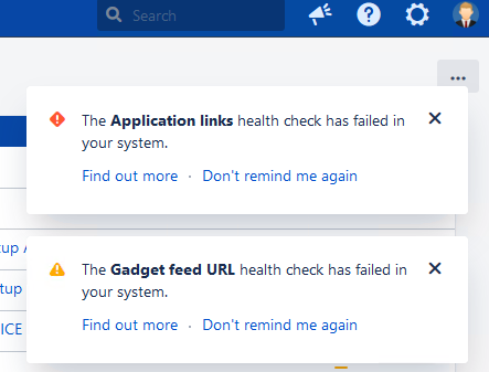

And one more thing. Even though those health checks have been successfully passed, JIRA keeps showing these warnings:
September 25, 2020
You'll need to raise it as a support request (I'm not an Atlassian, and there's no point me raising it when I won't be able to get into your systems to find answers to questions they may ask)
The application link failure means you've got one or more application links configured to systems that are no longer responding when Jira pings them.  It won't do any harm, but you may want to delete the broken links if you don't need them any more, or recreate them if you do.
Gadget feed problem usually means your base url is set incorrectly, or that the current server cannot reach itself (the base url) over your network.  Again, won't do any harm to your data, but some things won't work properly until it is corrected.

@Nic Brough -Adaptavist-The thing is that I have recreated the links and the Base URL and as a result of that JIRA has passed the health check on those problems, but those notifications are still showing up. Anyways, I got your point.

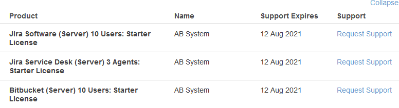

When I'm trying to request support:
request_support.pngII get this message showing up:
details_could_not_be_retrieved.pngIs there another way to raise the request?
