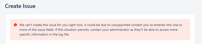

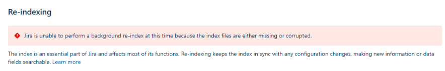

Hello,
Good day!!
We are getting "unsupported content" error message while creating a ticket in jra. And in the re indexing page it showing "some files are missing or corrupted". Please find the attached screenshots for the same.
Please suggest on this issue.
Thanks in advance.

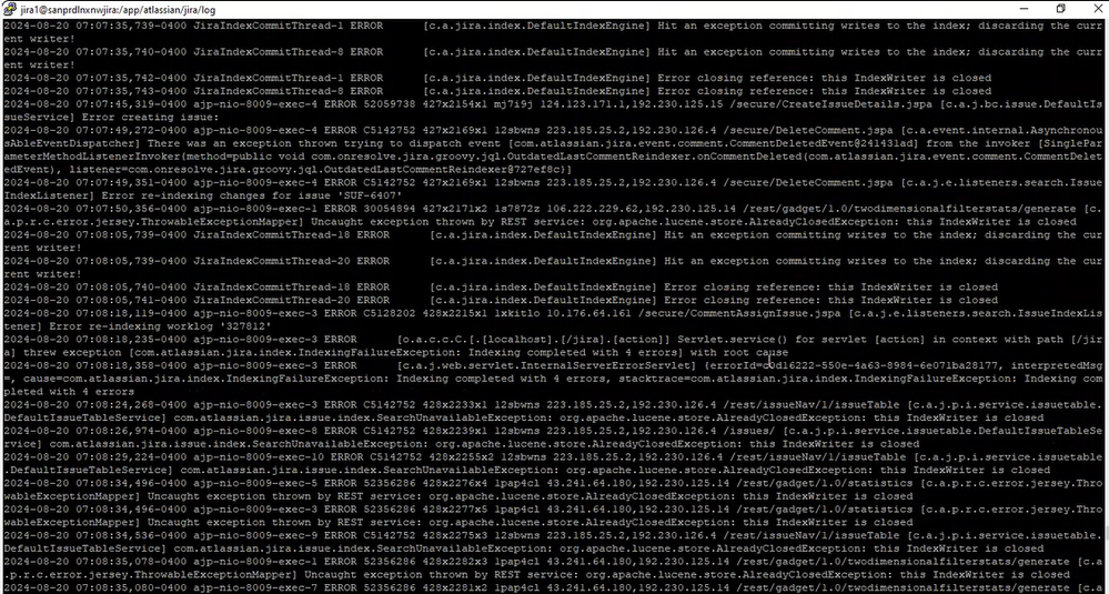

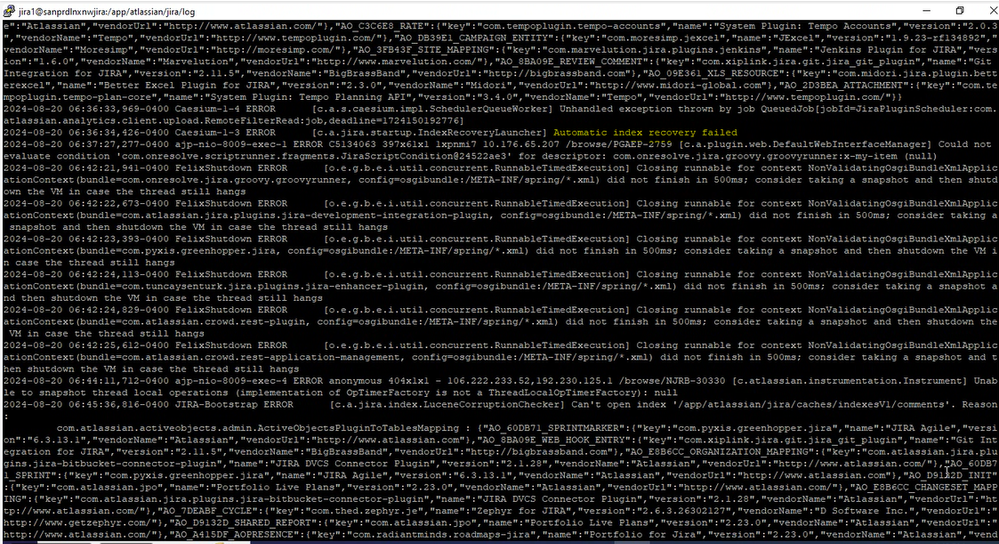

Santhosh Gosula
August 21, 2024
Thanks for your Advise!! @Samuel Gatica _ServiceRocket_ ,
Here are the blow some screenshots from the log file and in the log file we can able to see the below error. Please check and suggest what kind of error is this.
Caused by: java.nio.file.FileSystemException: /app/atlassian/jira/caches/indexesV1/entities/portalpage/pending_segments_1xe: Invalid argument
