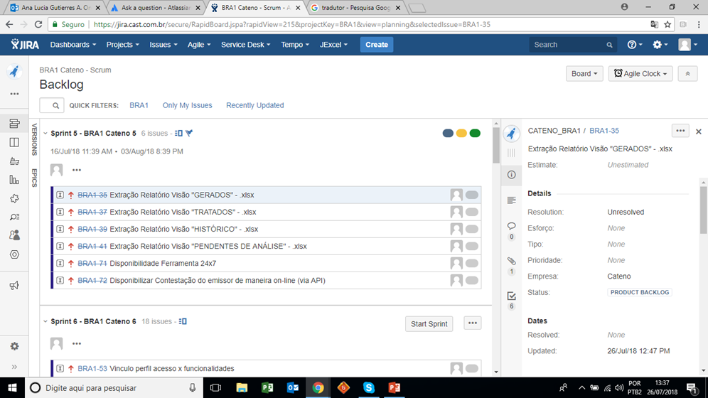

I have some issues that, even with resolution = "unresolved", they are crossed out.
I´d like to cross out just when the issue is with another status.

It looks to me like one of your inexperienced adminstrators has added "unresolved" to the list of resolutions.
Go to Admin -> Issues -> Resolutions and look at the list.  If it has "unresolved" on it (or any other phrase that means "not closed"), edit it and change it to "Broken Resolution option - do NOT select this".
Then check your struck-out, but unresolved issues again.

@Nic Brough -Adaptavist- Just what I created, because natively does not exist.
An occurrence starts with the value "unresolved", if with the progress of the flow you change the resolution to any of the others and try again to return to "unresolved" it does not appear in the list of the combo.
So I went directly to Admin -> Issues -> Resolutions, but this value also does not exist in the list of resolutions, so I created an "unresolved" resolution to meet user demand, which needs to be able to switch from any resolution to "unresolved" .

Thanks, that has cleared it up perfectly.  You say
That is the problem.  You should never do that.
Now what you need to do is:
  • Rename "unresolved" to "do not use" or something equally off-putting
  • Look at where you have put it on screens.  You must never have it on
    • Create
    • Edit
    • Transition screens that are not going to a "closed" status
That will stop the damage spreading.
Now you will probably want to fix the broken ones that now have "do not use" on them.  You need to do one of:
  • Push them through transitions with a post-function that clears them
  • Use a ScriptRunner built-in script to repair them
  • Add temporary loops with "clear resolution" post-functions to your workflow(s) and use them on the broken issues

Thank you Nic! I´m going to try it.

This is strange indeed. Have you tried to run the integrity checker in the administration-->system page? Also try reindexing, if you haven't tried that already.

If this occurrence had started as "Unresolved", and at one time I had edited "Fixed" and again for "Unresolved" before the transaction that would make this exchange, could this possibly cause the problem?
the passed integrity checker did not return any errors, "indexing" was also passed without any errors, our log does not contain an error linked to this project and in its database.
The version of the jira presented is version 6.4.”

Please make sure the Resolution field should not available on any Create/Edit screen or transition. It should only available on the transition screen where the user will closed/resolved the issue.

As you can see, the specific issue BRA1-35 is unresolved, yet the backlog is showing the issue with strikethrough as if it were resolved, there has to be either a database or indexing problem here.

I see it is BLACK not RED like it is normally when the field is null. Did someone add 'Unresolved' to the resolution list thinking that makes the issue unresolved in JIRA? I've seen that before.

@Joe Pitt Unresolved doesn't show up as red on my Jira. Maybe it does on a later version of Jira or on cloud? But yes that's a good thing to check.
