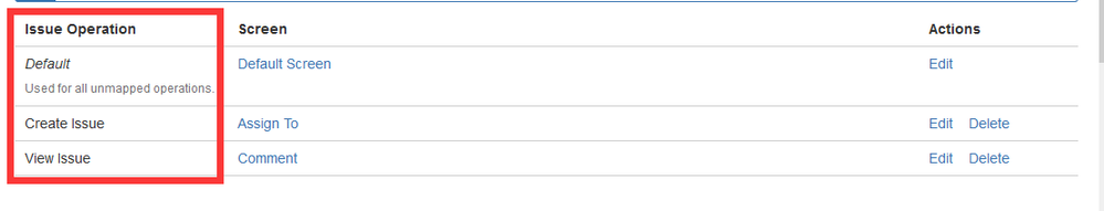

Hi @vishal03kadam,
From the description of the problem, it seems that view and editing issue refer to different screen.
vishal03kadam
June 11, 2018
Hi Ollie,
The Create, Edit, and View all have the same screen.

HI @vishal03kadam,
As you mentioned the same screen is using for all the issue operation(Create, view, and edit) then the below sentence would be wrong because if you are able to see the field on edit screen then you should be able to see the same field on Issue view screen as well.
Then I go to that issue and I could see that that field is not visible on the issue screen but now when I go to edit I could see that field in the edit screen

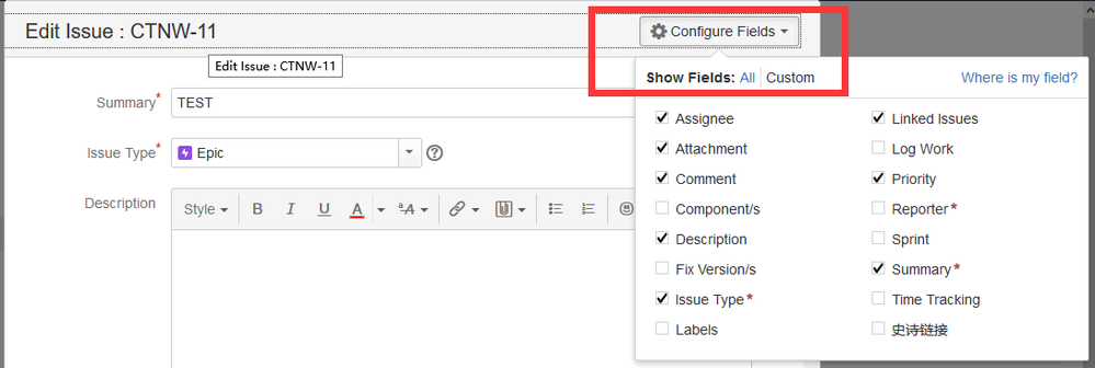

HI @vishal03kadam,
There will be two options to check ..

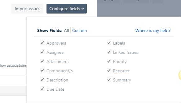

1. Just check is the user has checked the field from configuring field tab on the screen.
2. Another one is check if this field has been hide using the field configuration scheme of the project.

Hi @vishal03kadam,
Is this field hidden?
