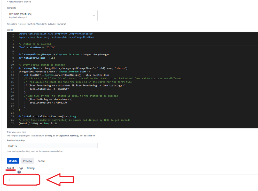

Hi all! i am trying to run the code from the link
 https://library.adaptavist.com/entity/count-the-time-an-issue-was-in-a-particular-status
But I am getting  time "0"
2 votes
Ram Kumar Aravindakshan _Adaptavist_
October 6, 2022

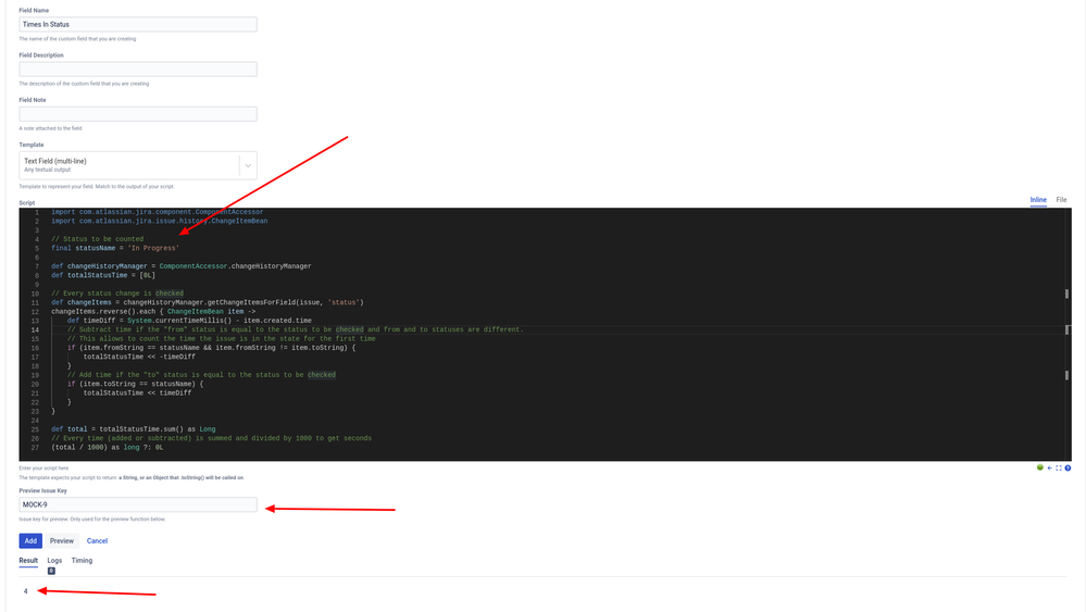

Hi @Alex
I've tested the code in my environment and do not seem to be encountering any issues. I can get the expected result, as shown in the image below:-
I've used the same code to test, with a minor modification to the Issue Type as shown below:-

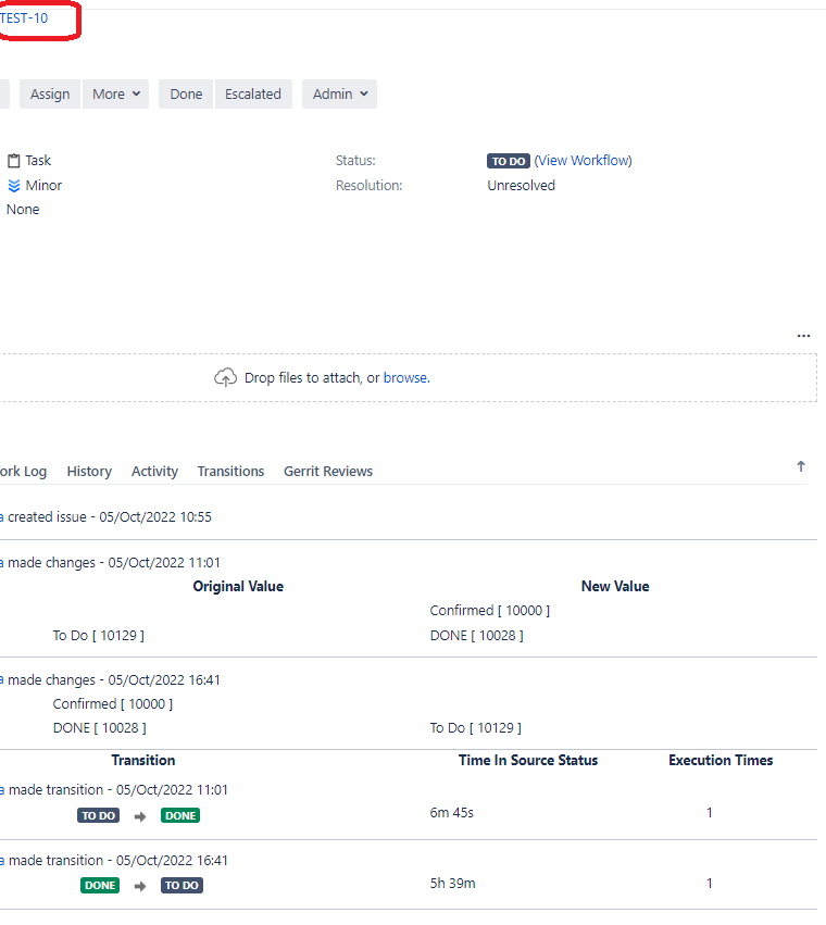

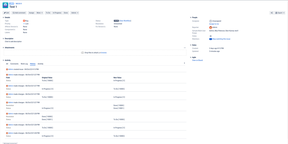

Could you please provide a screenshot of the issue history as shown below:-
Thank you and Kind regards,
Ram
Alex
October 8, 2022
@Ram Kumar Aravindakshan _Adaptavist_ hi! Thank you ! it's worked!

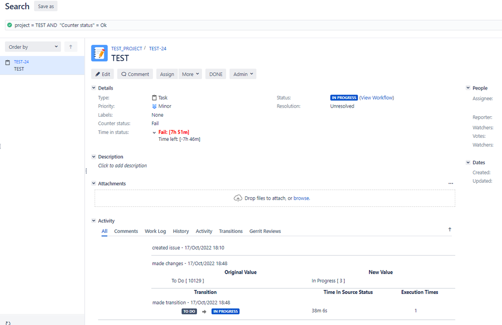

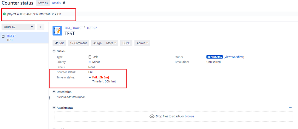

@Ram Kumar Aravindakshan _Adaptavist_ hello , I improved my counter a little , but now unfortunately I can not understand why tasks are not searched through jql search . by the "Fail" flag. Please could you help me understand what could be wrong here. Thank you.
Tom Lister
October 18, 2022
Are you setting the Counter Status field in your improved code?
Could you share the improved code?
Alex
October 18, 2022
@Tom Lister hi! Yes of course!

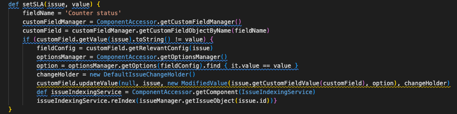

def setSLA(issue,value) {
fieldName = 'Counter status'
customFieldManager = ComponentAccessor.getCustomFieldManager();
customField = customFieldManager.getCustomFieldObjectByName(fieldName);
if (customField.getValue(issue).toString() != value) {
fieldConfig = customField.getRelevantConfig(issue)
optionsManager = ComponentAccessor.getOptionsManager()
option = optionsManager.getOptions(fieldConfig).find {it.value == value}
changeHolder = new DefaultIssueChangeHolder();
customField.updateValue(null, issue,new ModifiedValue(issue.getCustomFieldValue(customField),option), changeHolder);

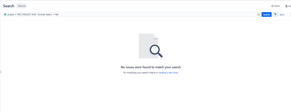

Alex
October 18, 2022
@Ram Kumar Aravindakshan _Adaptavist_ Perhaps there is a problem with updating this field in jira ? Because when I put the search on "Ok" (the choice in the field Counter status - "Ok" is the default) , then the search is performed and finds this ticket.

@Ram Kumar Aravindakshan _Adaptavist_  re-indexing did its job, but I can't start indexing with every new task. Now I created a new ticket, and it no longer worked in the search results

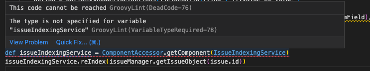

If you are running in the console, try adding this code in to reindex the issue
import com.atlassian.jira.issue.index.IssueIndexingService
import com.atlassian.jira.component.ComponentAccessor
import org.apache.log4j.Category
def issueIndexingService = ComponentAccessor.getComponent(IssueIndexingService)
Issue issue = issueManager.getIssueObject("KEY-999");
issueIndexingService.reIndex(issueManager.getIssueObject(issue.id));
There may be an issue if indexing is already running. There is a test for that, can't remember the exact call.

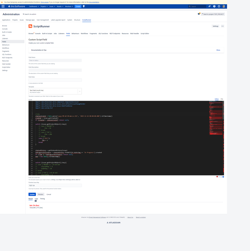

Alex
October 20, 2022
@Ram Kumar Aravindakshan _Adaptavist_  Hi! Last code used for a Scripted Field
jiratest.osmp.ru_plugins_servlet_scriptrunner_admin_scriptfields_edit_94932e05-b683-4429-8f96-91233e6fb4bc.png

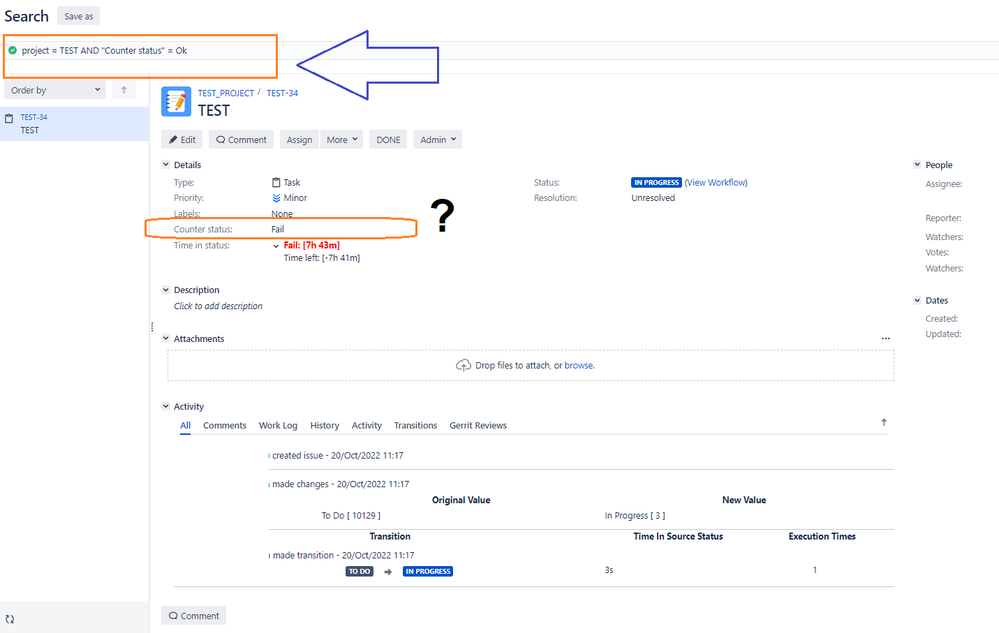

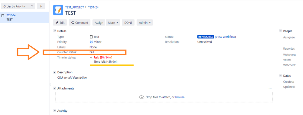

Alex
October 20, 2022

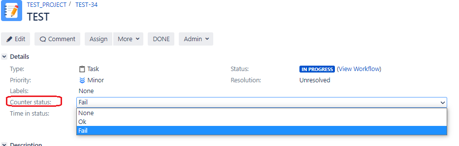

this issue (test-34) finds
JQL = project = TEST AND "Counter status" = Ok
(default value for cF "Counter status" - "Ok")
Alex
October 20, 2022
@Ram Kumar Aravindakshan _Adaptavist_ i assume jira itself is not updating..
Tom Lister
October 20, 2022
Hi @Alex
If you can see the expected value when you view the ticket then it has updated the issue.
When you perform a JQL search the data read is from the Lucene indexes. Normal operations keep the indexes in sync but they can get out of alignment when you are running your own operations. As you are finding with your script.
We are still not clear where you are running your script from. Or where you will finally run it. Different contexts behave differently.

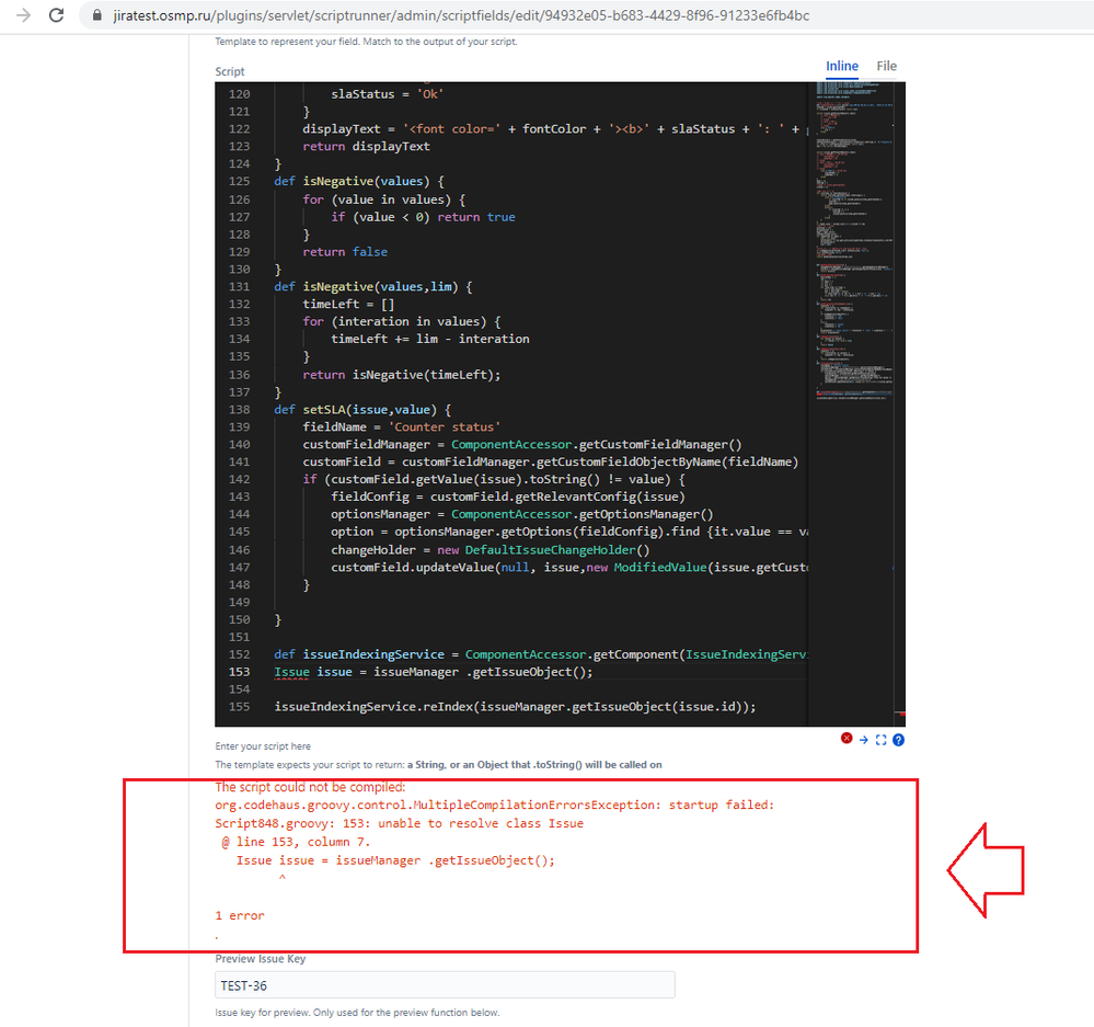

Try triggering the indexing within your code using :
/// all your existing code
October 24, 2022
Hi @Alex
I have gone through the latest code you shared, and I have noticed many mistakes in it.
Firstly there are many variables that you have declared without defining the type. For example:-
slaConstraint = Date.parse('yyyy-MM-dd HH:mm:ss.SSS', '2015-11-16 00:00:00.000').toTimestamp()
Instead, it should be declared as follows:-
def slaConstraint = Date.parse('yyyy-MM-dd HH:mm:ss.SSS', '2015-11-16 00:00:00.000').toTimestamp()
The language used is not Python, where you can just declare a variable without specifying the type.
It is Groovy, where you need to either specify the type for the variable or use the def keyword and let Groovy set the type.
Secondly, there is no need to use semicolons. In Groovy, semicolons are ignored.
Also, in this code:-
switch (issue.getProjectObject().key){
case ['TEST']:
lim = 5
break
if (!lim || !inProgressExistance)
return null;
I see the usage of the variable lim. Where has this been declared?
In addition to that, where have the variables fontColor, and slaStatus been declared, i.e.:-
def displayText = '<font color=' + fontColor + '><b>' + slaStatus + ': ' + getFormattedTime(timeSpent) + '</b><br /></font>Time left: ' + getFormattedTime(timeLeft)
return displayText
These variables cannot be found, which will cause an error, eventually resulting in a problem in the Scripted Field.
Even if these variables are added to the class you are importing, as shown below, you still need to declare them before you can use them.

@Tom Lister  Hi!! Thank you, I added the code that you attached, but for some reason I get an error
Tom Lister
October 25, 2022
Hi @Alex
It's because there is no explicit import for class Issue.
But you can remove that line and ignore it. You already have access to the 'issue' object in the context for this script.
so add the request before you end and return the field value

@Tom Lister  unfortunately no change. The task also did not change in the search.
Tom Lister
October 25, 2022
This screen looks like you have updated Counter Status to Fail but the indexes have still not updated so find the issue as value 'Ok'.
Where are you triggering the indexing in your code? Can you attach it as a text file so it's easier for me to read in an IDE?
Indexing may not run if another indexing process is already running. Is that the case?

HI @Alex
The reindexing is at the end of the code after the function definitions. I don't think it can be reached there as your code execution will finish at the return
return getDisplayText(workTime,lim)
Try placing the reindex request just before that statement,  before you end and return the field value
Tom Lister
October 25, 2022
alternatively place at the end of the setSLA(issue,value) function

@Tom Lister the final setSLA() function should be like this ?
        issueIndexingService.reIndex(issue)
        def issueManager = ComponentAccessor.getIssueManager()
if so then I get an error and after two minutes (the time given is "ok" 2 min) the counter disappears completely from the ticket
log

you have omitted the line
 the line
has no effect on any processing in this case

October 5, 2022
HI @Alex
It may help to put in some log statements to show the values being obtained during the process .
What is the history of your TEST-10 item with status TO DO?
Alex
October 5, 2022
@Tom Lister  hi!
Tom Lister
October 5, 2022
Hi @Alex
The field type template should be Duration but that isn't the issue.
If I dry run this in my head, Your loop should process two events. Each of which will match one of the given conditions. So the net effect is one pass will add -timeDiff and the other will add +timeDiff. So giving a zero result.
As I mentioned you would have to add log statements to see some confirming debug info. I don't think this logic will work for this test case if any.
I've tagged adaptavist so hopefully they will jump in. If I had a running server instance I would try to recreate it.
