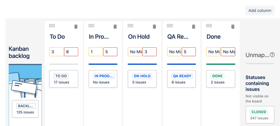

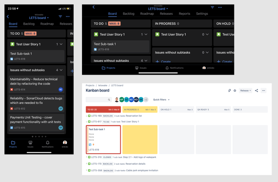

Here is the screen of configuration:

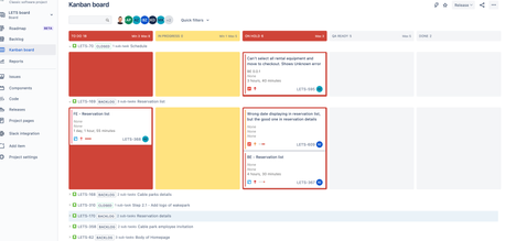

Desktop app shows all tickets:

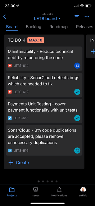

While mobile app just a few of them (should show 18 issues):
Where is the problem?
If I change swimlane by Queries, it shows everything correctly. The problem exists only with Stories selection.

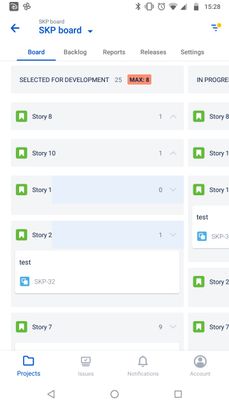

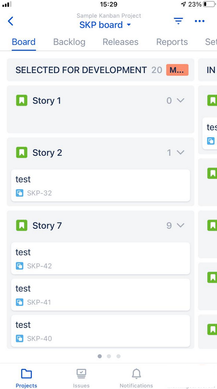

Testing on my local site, I created a board and added JQL and also the swimlanes based on Stories, but I wasn't able to replicate the issue.
On both Android and iOS it shows the swimlanes:
Can you please let us know what is the app version you are using?
Also, I see that the stories are on the status Closed or Backlog, is it happening when the status of the story is To Do?

Regarding statuses:

Okay, but why desktop version is working correctly? I would like to see the same result on the mobile app :)

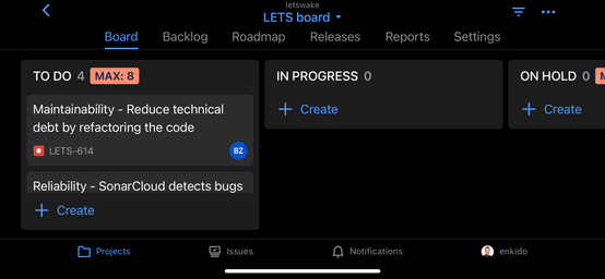

Are those 4 tickets from your second screenshot under a story?
No. They they (tasks) don't have sub-task (child's) so that's why you seeing it.
Can you create a new story as a test, add one sub-task, and change the status to "To Do" on both tickets?
Sure. You can see them correctly in mobile and the desktop. This is what I want to achieve in mobile version to be honest :)
I just don't want to add parent issues in the board, because they are used only as a reference (like epics). Also, you can see quantity of issues in the column so I don't want to increase that number by adding parents which is not suppose for development. (Developers are working only with sub-tasks and I as a Product Owner close parents from backlog to Done or Closed statuses once all sub-tasks are completed)

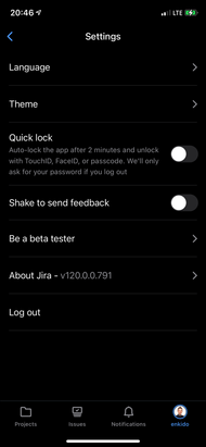

Also, you mentioned that you are using a beta version, can you please uninstall and use the production version?
Done. Already using production version. Build: v120.0.0.791
p.s. If mobile app flow could follow desktop app flow, we won't discuss about it, but it seems a different logic is used for mobile app board items displaying :)
