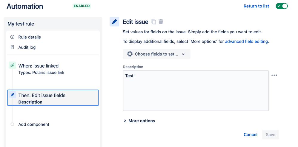

I'm doing some work on our automation rules, but I'm struggling to get going. I've got my rule set up as I believe it should be, when a Polaris issue is linked it should edit the linked description to 'Test!'
I want to run this rule any time a 'delivery ticket' is created
However, when I create a delivery ticket, nothing happens anywhere that I can see. Not on the created ticket, the original ticket, etc. I've tried setting it to send an email to myself, but still nothing.
Any clues as to where I'm going wrong? This rule is limited to the dummy project I'm working on.
Thanks in advance!

Hi @Jacob Powell ,
The creation Issue Event dont call your Automation.
You can try to do something like this in an Automation:
Triger of the Automation:
  • When issue Created,
Add a condition of "Related issues condition"
  • Related issues: Linked Issues
  • Link Type: Polaris
  • Rule Resticted, to your peoject.
Then:
Edit the Description.
*Note : For the Update Actions, your Automation is OK.

Hello @Jacob Powell
When you create the delivery ticket are you also entering information to link that to another issue using the Polaris Issue Link? If so, then this rule will be triggered during issue creation. If you are not entering the link information during issue creation then this rule will not be triggered.
The next tricky part is understanding exactly which issues in the link pair causes the rule to be triggered.
Notice the description for the Trigger. The issue that will be considered the Trigger Issue is the one that shows in its Linked Issue section the Outward Description. In your scenario which issue is showing the Outward Description for the link relationship for Polaris Issue Link? And which one of the pair do you actually want to edit?
Rule executes when an issue is linked to another issue. {{issue}} will always refer to the source issue, so if ISSUE-A is blocked by ISSUE-B, this rule will execute on ISSUE-B. To access ISSUE-A, use {{destinationIssue}}, and to access the link type, use {{linkType}} (e.g. {{linkType}}

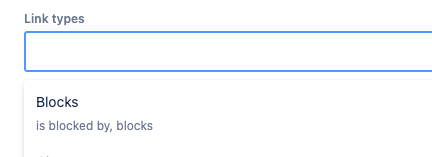

For the "Polaris Issue link", what are the Inward and Outward Descriptions associated with that link type? When you select the link type in the trigger you should see something like this with the Inward Description shown first (is blocked by) and the Outward Description shown second (blocks).
Once we understand which issue in the link pair is triggering the rule, and which one you actually want to update, then we can provide specific advice on how to accomplish that.
