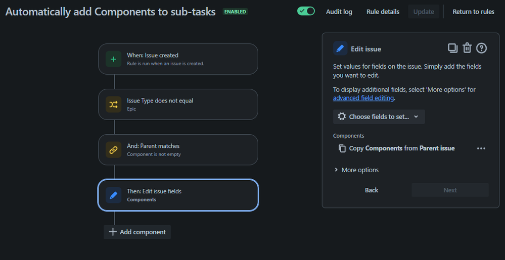

I am trying to have a new sub-task automatically inherit the parent's component.
Why is the below automation now working?

Hi @Darryn
Looking at the original rule you posted, it uses the Issue Created trigger.  That trigger may fire so quickly that some data may not yet be available to the rule yet.  This particularly applies to smart values like {{issue.parent}}, {{issue.subtasks}}, etc.
The "fix" for that timing problem is to always add the Re-fetch Issue action immediately after the Issue Created trigger.  This will slow down the rule a bit and reload the data before the rule continues.  Please try adding that action and re-testing.

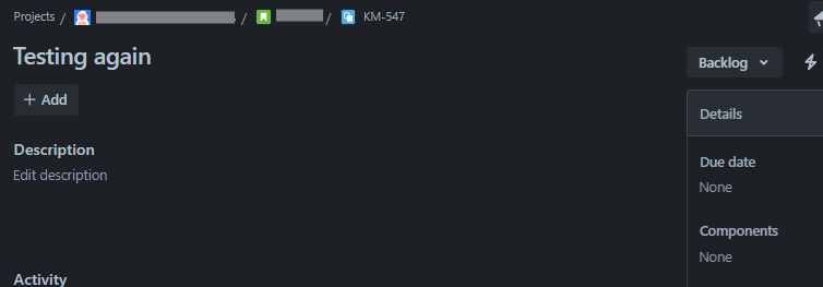

On all test issues I've created (including KM-547 above), the Component field value has remained "none"...
