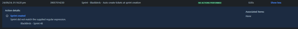

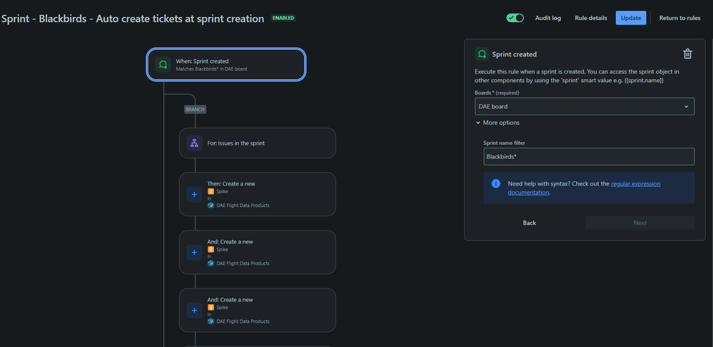

Please can someone support me, I cannot work out what is going wrong. I have tried running the "then" commands below the "when", and now additionally under a branch, but every time a new sprint is created it says "NO ACTIONS PERFORMED"
I have tried changing the regular expression to ^Blackbirds* and many other options, but nothing seems to be triggering it.

When the Sprint Created trigger fires, there are no issues in it yet.  And so the branch you show will not find any yet.
You describe wanting to add some default issues to the sprint when it is created.  Your rule could be changed to the following to accomplish that:
  • trigger: sprint created
  • action: create issue, and set the Sprint field to {{sprint.id}}
    • To enter the smart value for the Sprint field, type in the expression and it will appear below the field.  When it does, select it for use.
  • ...repeat as needed

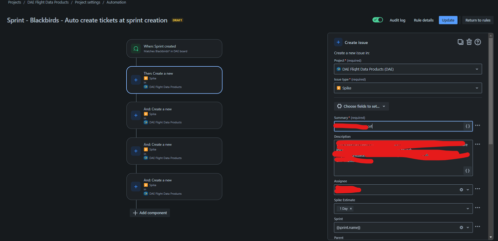

So this is what I originally had, but it would say nothing triggered:

Please show an image of the audit log details to help provide context.
In the Create Issue action, please use {{sprint.id}} and not the name.  That will ensure the correct sprint is used (and avoid any potential collisions).
Finally, did you in fact create a sprint in that board exactly matching that regular expression at the start of the name?

You can't use {{sprint.id}} in the name.

I was noting in the assignment of the Sprint to the created issue, and not in the filter for the trigger.

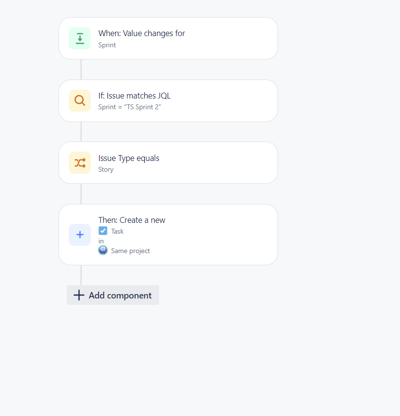

The automation above will create ticket/s only when you will move the Story on a new sprint.
I have added a condition to run only for story ( but you can add what issutype you need)

When Sprint is created the sprint is empty.
The real action happen when you move the ticket from Backlog to the new Sprint.
You can try:sprint11.png
This will check each ticket that have updated to Sprint field.
It will check if Sprint = desire value
If yes it will created a new ticket.
