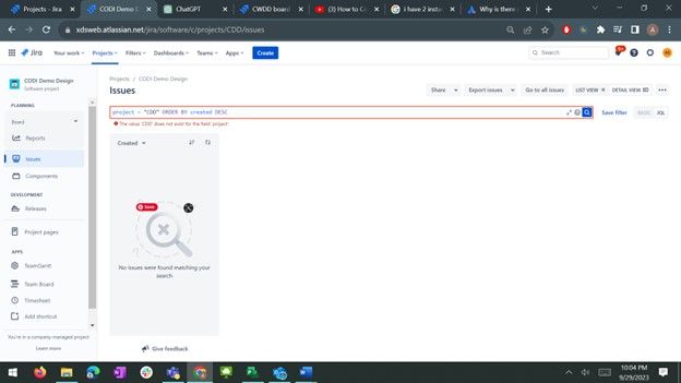

Instance B also gives me the error, "The value 'CWDD' does not exist for the field 'project'."

Hello @Aveetha Singh
Can you provide screen images of what you see? It is hard to diagnose the problem based only on what you say is not present.
How did you create the Scrum boards? Did you create new projects and select Scrum Board when selecting the template, or did you create a scrum board separately based on a saved filter?
If you think you created a scrum board in instance B but don't see "Backlog" or "Active Sprints" in the navigation options, then there is a strong possibility that you did not actually create a scrum board there.

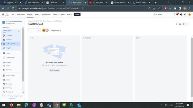

Aveetha Singh
September 29, 2023
This is Instance A:

Aveetha Singh
September 29, 2023
Hi Trudy
I created the Projects and selected scrum boards. The process worked in Instance A but not in Instance B
Trudy P Claspill
September 29, 2023

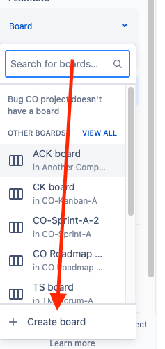

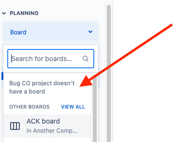

Instance B's project does not actually have a board associated with it. You can tell this by looking at the navigation pane on the left and seeing that the pull-down above reports says simply "Board". If there was a board associated with the project then it should display automatically. You can pull-down that field to see if there is a board available to select, but you will probably see a message like this:
If that is the case you will have to create the board. You can do that by selecting the +Create board option from the bottom of the list.
Then walk through the wizard selecting to create a Scrum board from an existing project.

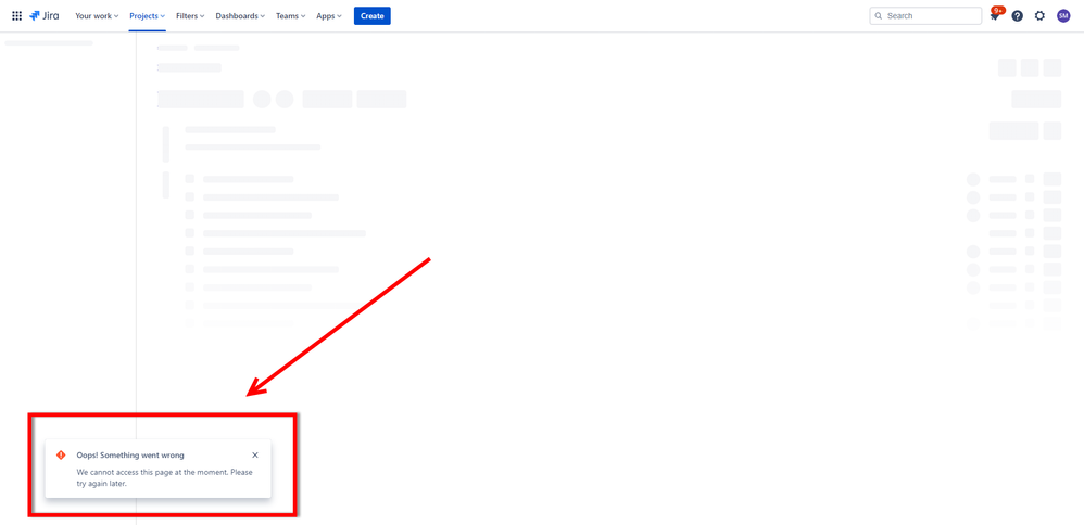

Siyabonga Mahlangu
October 2, 2023
Hi @Trudy P Claspill
Whenever I try to create the scrum board from an existing project I get an error message
Trudy P Claspill
October 2, 2023
This is beyond my abilities to debug, as just another user of the products.
I recommend that you reach out to Atlassian Support directly at:
https://support.atlassian.com/contact/#/
