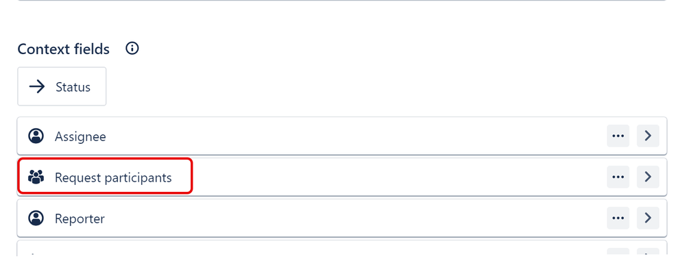

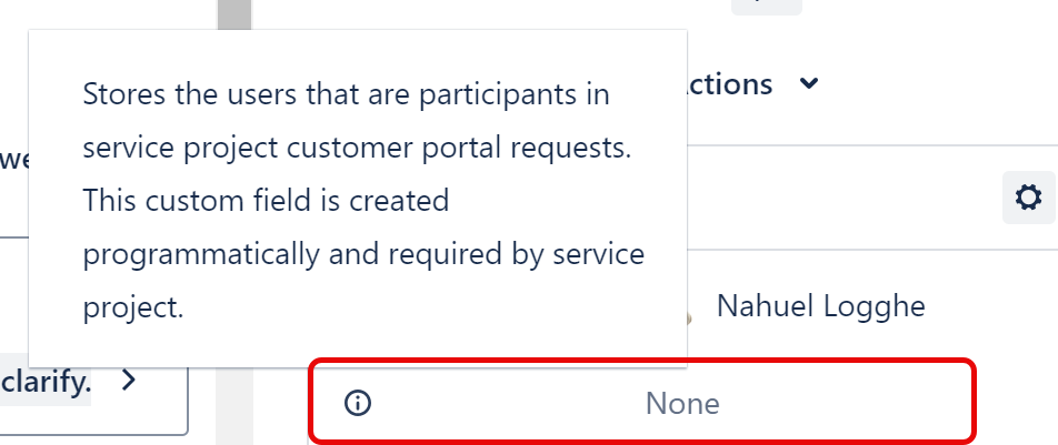

I have added the Request Participants field to the task issue type, but it appears blank when opening an issue and cannot be edited. Please refer to these two images for reference:
