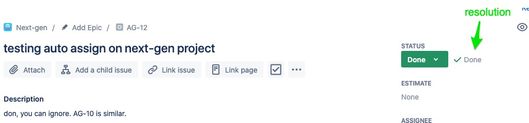

I should have mentioned that the aging is for NG Kanban. NG Scrum will remove all issues from the board when you complete the sprint. I'm guessing you are using Kanban though. Now can you look at one of these old issues and see if there is a Resolution set as in below...
If you are not seeing the resolution then that would explain why it is not aging off as the Resolution being set is the trigger.
you may also note the color of the Status: Green = done category and Grey = to do stuff and if blue the it is In progress category. Now I'm not a NG expert as I rarely use these templates, but my understanding is that the FRMC is considered Done by default and the resolution should be automatically set. I did not think you could have an issue in Done w/o resolution. Will be interested in what you are seeing. Could you add screenshot of your board?

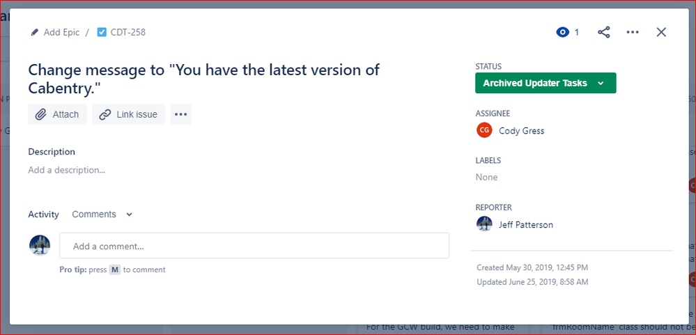

Jeff Patterson
October 31, 2019
That must be it!  These older issues are not marked with a resolution of "Done":

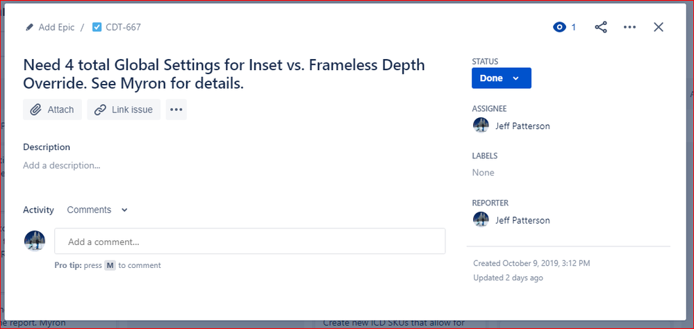

Even our issues in the Done column are not marked "Done":
I don't even see how to do that from the Board.  How do you set the Resolution to Done?

Jack Brickey
October 31, 2019
With NG the RHMC is the only done category status and the only one green.  I would definitely clean this up and not have the archived.
