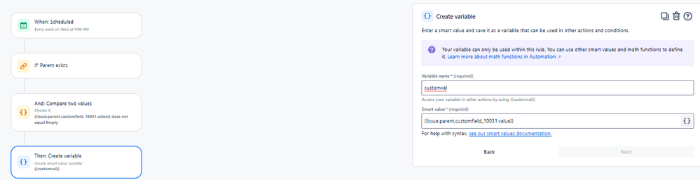

I have a custom field in Jira for "Community/Entity" that prompts me to select a community, then prompts me to select an entity #, then merges the two dropdown selections into one field with the Custom Field ID # (10031). I am trying to write an automation where if the parent has the "Community/Entity" field filled out, automation will fill the "Community/Entity" out for the child issues.
I have created a variable name:   customval
Smart Value: {{issue.parent.customfield_10031.value}}
Here is the "edit issue" value I am using:
{"fields": { "customfield_10031": {"value": "{{customval}}"} } }
My branch is For JQL parent = {{issue.key}}
Then Edit the issue additional field:
{ "fields": { "customfield_10031": {"value": "{{customval}}"} } }
When this automation runs it returns successful, but only the community updates and not the entity#.
Thank you in advance for your help!

Can you provide a screen image for an issue where both these fields are populated, showing those two fields? Community_Entity Field.png
Why are you merging and copying the data from the first to the second? People are filling out the Community/Entity for the parent, but not doing it for the child issues, and it needs to be done for reporting and analytic purposes. We are trying to avoid making this field mandatory by just copying from the parent if the stories are left blank. Each community has an associated entity number. The business just chooses to use a custom field to view this as one field vs two.

Trudy P Claspill
March 27, 2025
Thank you for that additional information.
So you are trying to copy data from field "Community/Entity" in the parent issue to the exact same field in the child issue. The field is a Select List (cascading), and its ID is 10031.
The bit about merging and copying the data to a field confused me.
I agree with @Bill Sheboy 's suggestion that you try using the COPY option rather than the JSON editing option.
In the Edit Issue action, after selecting the "Community/Entity" field, click on the three dots to the right of the field and select copy
That will insert some text as shown below. Click directly on that text.
That will open a pop-up allowing you to select the source issue and the source field from which to copy the data. You should be able to change the Issue to copy value from selection to Parent. (Ignore my red arrow below. I copied this from another post I made about changing the source field in this copy operation.)

The problem I am having is "Community/Entity" is not an option I can choose in the "Choose fields to set" dropdown, so I have to use more options, additional fields and code to "find" it.

I believe the answer is provided by @Mark Segall in an answer he put on this post:
https://community.atlassian.com/forums/Jira-questions/Automation-Copy-select-list-cascading-custom-field-from-an-issue/qaq-p/2347573
"update": {
"customfield_10031": [
"set": {
"value": "{{issue.parent.fields.customfield_10031.value}}",
"child": {
"value": "{{issue.parent.fields.customfield_10031.child.value}}"
I tested this in my own environment, with an appropriate id for a Select List (cascading) field, where the child issue was the trigger issue of the rule. It worked.
Like • Ganea_ Merissa likes this
Ganea_ Merissa
March 28, 2025
Thank you for spelling out the code I need to use...This worked!!
