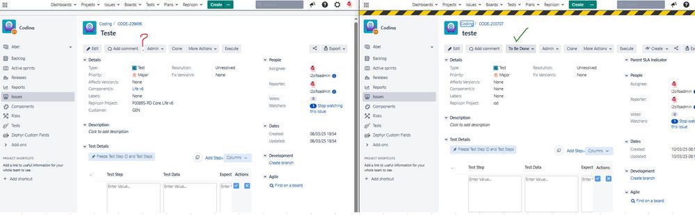

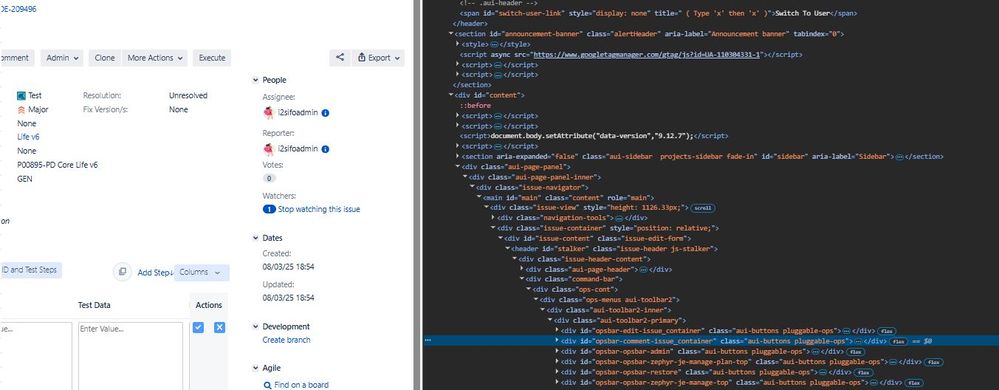

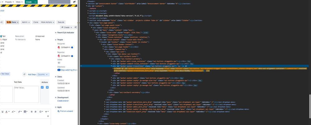

In jira data center 9.12, it shows the issue but div class="issue-header-content" is missing div id="opsbar-opsbar-transitions". What could it be?
  • In production environment dont' appears:
  • In test environment appears the buttom of transitions "To Be Done"

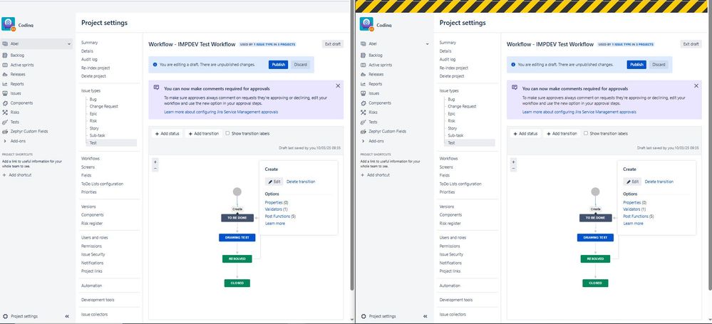

I analysed the workflow of the issue type and searched for a script runner, but I didn't find one. I dont' know the reason why that happens. Could you please suggest more possible causes?
  • Production Vs Test environment

The attached image indicates that there is no condition in that transition, so I don't believe it is related to any condition that would be preventing the transition buttons from appearing.

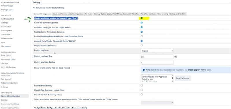

We have already resolved the situation, this was the cause:
