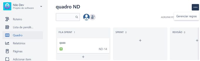

So, i cant find the board settings . What happend? Go to your board, then select more (•••) > Board settings.
I select my board then go to (...) and appear other option, "manager yours rule"

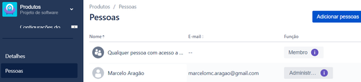

Marcelo Aragão
November 11, 2018
so, im the admintrator...
Nic Brough -Adaptavist-
November 12, 2018
You might be a system admin, but you're not an admin of that board. These are different things.  Ask the admins of that board to add you as an admin.

November 12, 2018
If you created it, then you are an admin of it.
Given that, then ff there is no "configure" option for it, as in your screen-shot, then it is not a Software Kanban board, it is a board that comes with a "Next Gen" project, which do not have configuration options.
