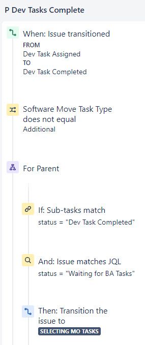

The automation is set to transition a parent issue to Selecting MO Tasks if its current status is Waiting for BA Tasks, when the issue’s sub-task is transitioned from Dev Task Assigned to Dev Task Completed.
It was working until I modified fields, screens and workflows.  The error mentions a problem with the destination status, but I don’t see a problem with the status name, so I’m guessing there’s a hidden problem such as a screen missing an association.
Automation log error:
Transition issue
Destination status could not be resolved. If using a smart-value ensure this resolves to a numeric status ID or untranslated name for issues (with current status):
TAST6-1025 (Waiting for BA Tasks - 10200)
Relevant piece of automation:
Relevant parent workflow statuses:
Relevant sub-task workflow statuses:

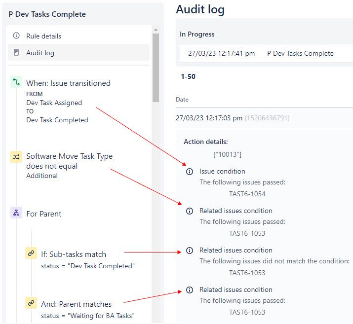

I changed the condition from
   Issue matches JCL > status = "Waiting for BA Tasks"
to
   Parent matches status = "Waiting for BA Tasks"
There was no error, but the sub-task condition "If Sub-tasks match status = "Dev Task Completed", that comes before the "Waiting for BA Tasks" status condition (the one that was mentioned in the original error) did not match the issue.  Please confirm from the screen shots below:
Beginning of automation

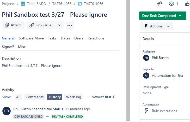

The status of the only sub-task created by the parent issue

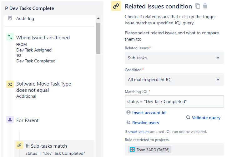

The Rule condition that is not matching

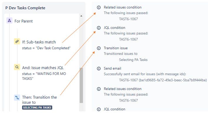

Unfortunately, seemingly the same as yesterday morning, the automation has inexplicably stopped working.
I'm now not sure which log message belongs to which condition or action.  Below is a screenshot with my added arrows from this morning.
I wonder if I somehow changed one transition name to another some time ago, because unless the log message relates to the JQL condition, despite the message including the word "destination", the status name is wrong.
I sure would like to know if the message refers to the JQL condition or the Transition action, but either way, I don't understand how this could work and then stop working.
