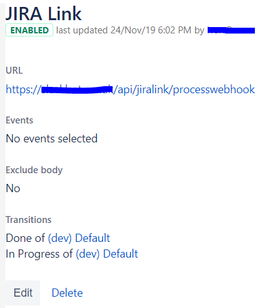

I think that webhook is configured properly, but on the other hand I don't see any issue from app side. So I'm confused and need a help.

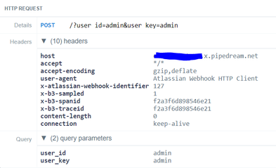

My webhook is triggered as post function and was added as last step to transition. I've tried to put url from a pipedream service to test post request from webhook and it works correctly. I received request with two query parameters: user_id and user_key.

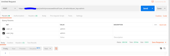

As you can see below I've also tested my endpoint via postman and it works.
What the problem could be?

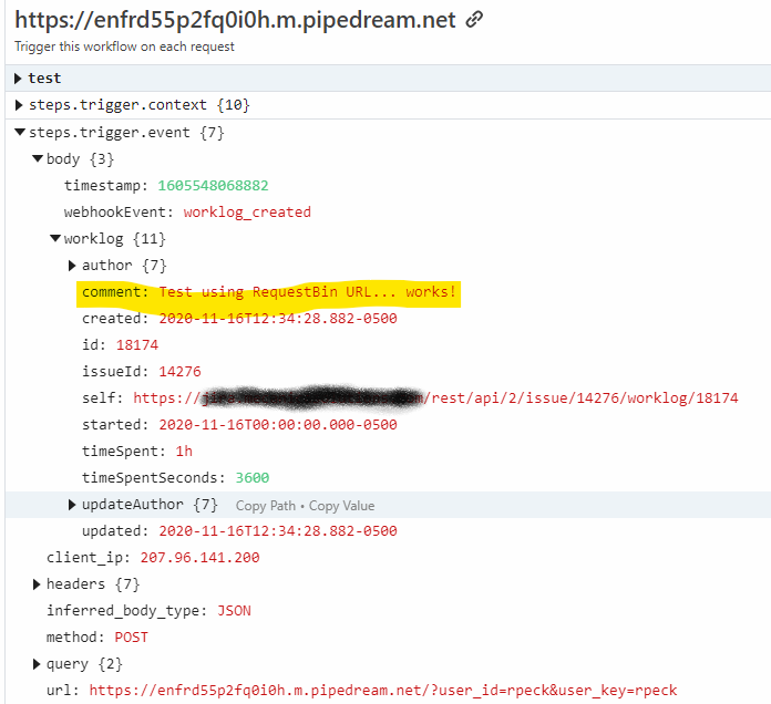

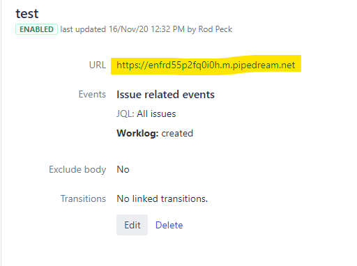

I am having this same issue. If I use the Requestbin URL, it works, but when I use my application url it does not reach it. If I use curl from the JIRA server to send to my application end point the same data payload it works, so I know it is not an issue between the JIRA server and the application end point...
Below is the requestBin result and below that is the configuration of the webhook. If I simply change the URL on the webhook, in the JIRA traces I see no difference except I do not receive the "WebHook successfully sent" message after the "Posting to web hook at 'https://myurl/functions/JIRAWorklogWebHooks?user_id=rpeck&user_key=rpeck'" that I do receive when using the url for RequestBin...
