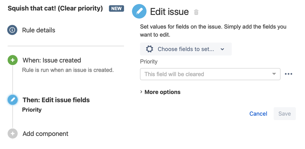

1. In Jira Data Center 8.22.x, I have a Priority Scheme where the default priority is empty. I'm working in a project where Priority is not a required field.
2. I created a Project Automation rule to clear the Priority field value for newly-created issues.
3. When creating new issues, the issues have a Priority value set. 🫤🫤🫤

Dave Liao
April 5, 2023
Hi @Kimberly Deal _Columbus ACE_ !
For #2, I set the Action "Edit issue fields", then cleared the Priority value.
You can see "This field will be cleared" is shown. It doesn't actually do what it says. I confirmed Priority is not a Required field for this project. 😅
April 7, 2023
Ooph!  yeah, same.  I guess it just isn't possible for Priority to have a Null value.
Wound up using Labels to do what we wanted to do with priority.  Not ideal, but a decent workaround.
I used Automation to set the label and lowest priority on creation of issue, so as not to affect shared workflows or system defaults.
