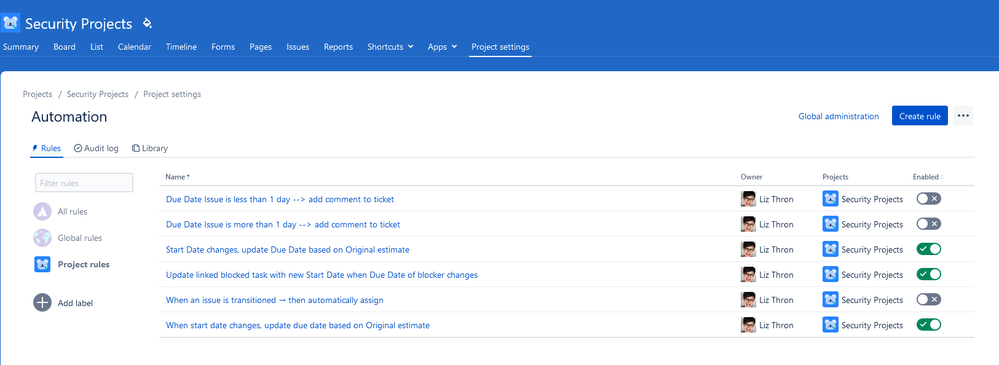

There are no automations of that nature that I set up on that particular board, I only have a couple turned on and they have nothing to do with the Assignee. The history shows I changed it, which is correct because I saw it happen when I went into the tickets and changed them to "In Progress" for my team members, but it happened through some sort of automation that I didn't set up and can't find. I'm mystified as to where to look or how to get it to stop. It only happens on the Company-managed board, not the Team-managed board. But I can't find a global automation that would do this either.

I went to the Global Automation Audit Log and there were absolutely no rules that fired, on that board or any others during that time.

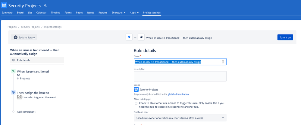

I know the rule is available in the library templates, but I don't have it turned on.
Just for "fun" I enabled the rule, so it would show in my list, and then turned it off. However, the behavior is still happening...it assigns the issue to me if I change the status.
