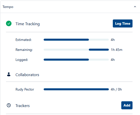

It seems that for some issues in our environment, the remaining estimate is not calculated correctly :
Even though 4 hours of the original estimate were logged, in the Tempo area of the issue it shows a remaining of 1h45m?
There were no manual interventions on this issue.
What goes wrong?

Duc Thang TRAN
April 10, 2025
Hello @Bert Duhamel
I think Rudy Pector  initially logged time for X hours, then later corrected their worklog by reducing it by 1h45m. This difference was automatically added back to the remaining estimate.
For example: if I originally logged 5h45m and then updated it to 4h, the 1h45m difference would be returned to the remaining estimate. You can check the logged time to see if that's what happened
Bert Duhamel
April 10, 2025
Thank you for your reply, as a matter of fact, I thought something like that might have happened, however in the history of the issue I couldn't find a manual correction of the remaining time.  Could this have been a manual adjustment of the remaining time performed by the person who made the logging?

Duc Thang TRAN
April 10, 2025
@Bert Duhamel
Normally, when updates the worklog and the time spent is less than the initial estimate, the difference is added to the remaining estimate. They can minus this difference or  set it to zero (if before change , remaining is 0) to avoid add more time to the  remaining
Normally, you can view the log in the history of this change
For this ticket , If remaining estimate  is available in the edit screen, you can also delete the value directly.
