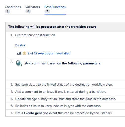

Hi @Gaston
This is a very subjective question. Firstly, how many Post-Functions do you have in the transition you are testing with?
Also, could you share the code you are using so I can review it and provide some feedback?

Hi @Gaston
When running this via the Post-Function, do you have any other Post-Functions configured for this transition? If yes, please try to move this Post-Function to the very top.
Also, from the code you shared, you are trying to create a new Issue via Post-Function. Please confirm if this is correct.
If yes, I would advise you to change your approach and simplify it using ScriptRunner's HAPI feature, as shown in this ScriptRunner Documentation.
I am looking forward to your feedback and clarification.
Thank you and Kind regards,
Ram
Hi @Gaston
Well, it appears that the other Post-Function(s) above it were taking a bit of time, resulting in the delay. Now that you have moved it to the very top, it will be the first to execute so there won't be any more delays for it.
I hope this helps to solve your question. :-)
Ram

Do the transition's postfuntions run in parallel and affect each other's execution time?

the whole transition in fact went down from 20 seconds to 2 after placing this postfunction first.
But what's the technical explanation? What's happening under the hood?
Hi @Gaston
A simple test you can do is disable all other Post-Functions in that transition except for the one you are testing now, i.e. which uses ScriptRunner, and run it again. You could now even move the Post-Function to the very bottom.
This will prove that this Post-Function is not causing the delay, but another Post-Function is. Once you run the test with only the ScriptRunner Post-Function enabled, start re-enabling your other Post-Functions one by one till it slows down. Doing this you will be able to narrow down which Post-Function is actually causing the delay.
