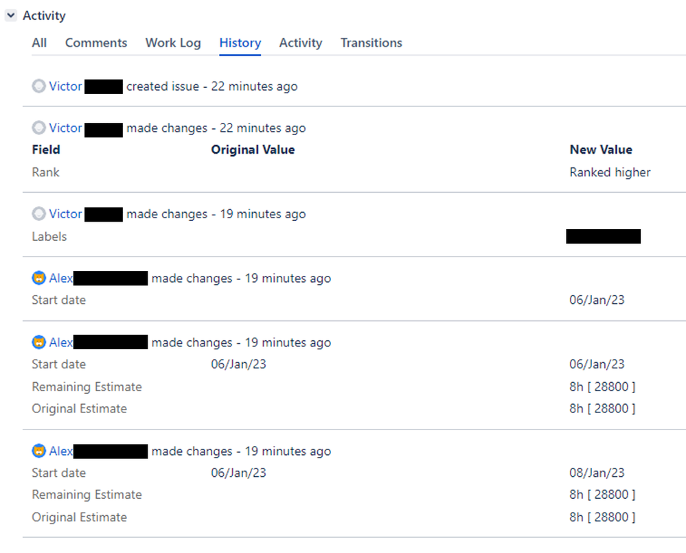

The Start Date value is automatically changed whenever I add a label to an Initiative, Epic or Task, which in turn pulls it in my Advanced Roadmap/Plan through a query. Below are the steps to reproduce:
1. Create Initiative, leave Start Date blank
2. Add label
Result: the system makes the Project Lead automatically change the Start Date. See below screenshot:

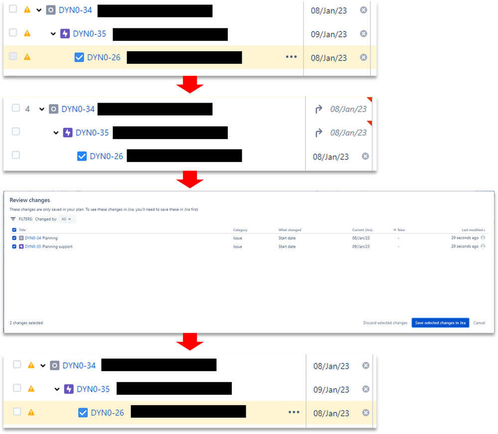

Another occurrence of this issue is on the Advanced Roadmap where I try and correct the Start Date but to no avail. After removing the Start Date, the Start Date is automatically rolled up. When saving the changes to Jira and doing a refresh the values are changed again. See below:
This happens to existing items in the plan and also right after creating new items. No matter if they're labelled or not. The thing they have in common, despite the project they're from, is that they're connected to this Plan and are created by me.

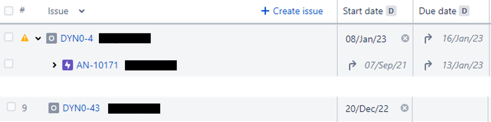

Note: a Start Date prior to 2023 remains unchanged. See below picture:
