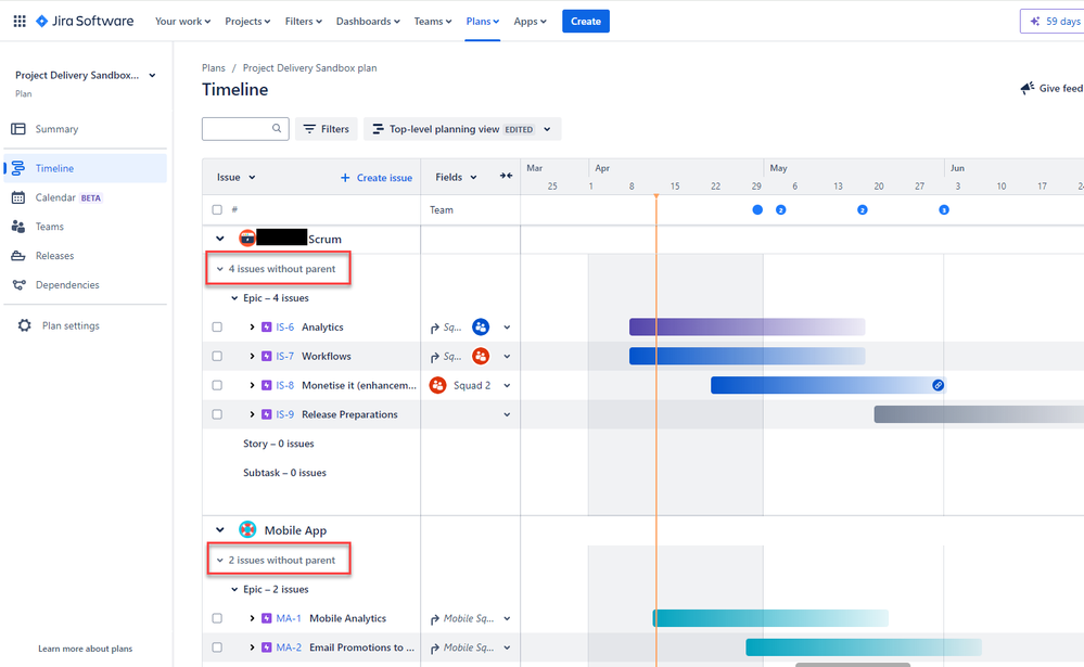

I am evaluating Jira Premium & specifically, Plans.  I have created some dummy projects with Epics, stories, tasks, some teams etc.  All tickets are associated with parents, the parent for the Epics is the initiative (plan)
However in my Plan - timeline view, it shows 4 issues without parent (and underneath, the 4 Epics) and I don't understand why.  I've been through the documentation and not any clearer

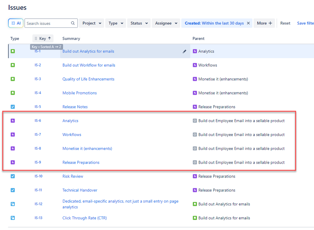

Also, if you run a filter (query) and display the Parent field, is it empty?
Christine Houlding
April 12, 2024
Thanks for responding - here are some screenshots showing the Plans view (which shows issues without parent) and filter view (showing the Epics do indeed have the parent, which is the initiative)

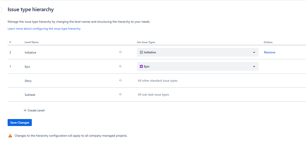

Can you share your Issue Type Hierarchy?
Christine Houlding
April 15, 2024
Here is the hierarchy:
However I set the dummy projects up as team managed projects for speed, so when I go into Project Settings - Issue Types, I see only Epic, Story, Task, Bug, Sub-Task.
John Funk
April 15, 2024
Correct - Team-managed projects will not use these.
https://support.atlassian.com/jira-cloud-administration/docs/configure-the-issue-type-hierarchy/
See the line in blue.
