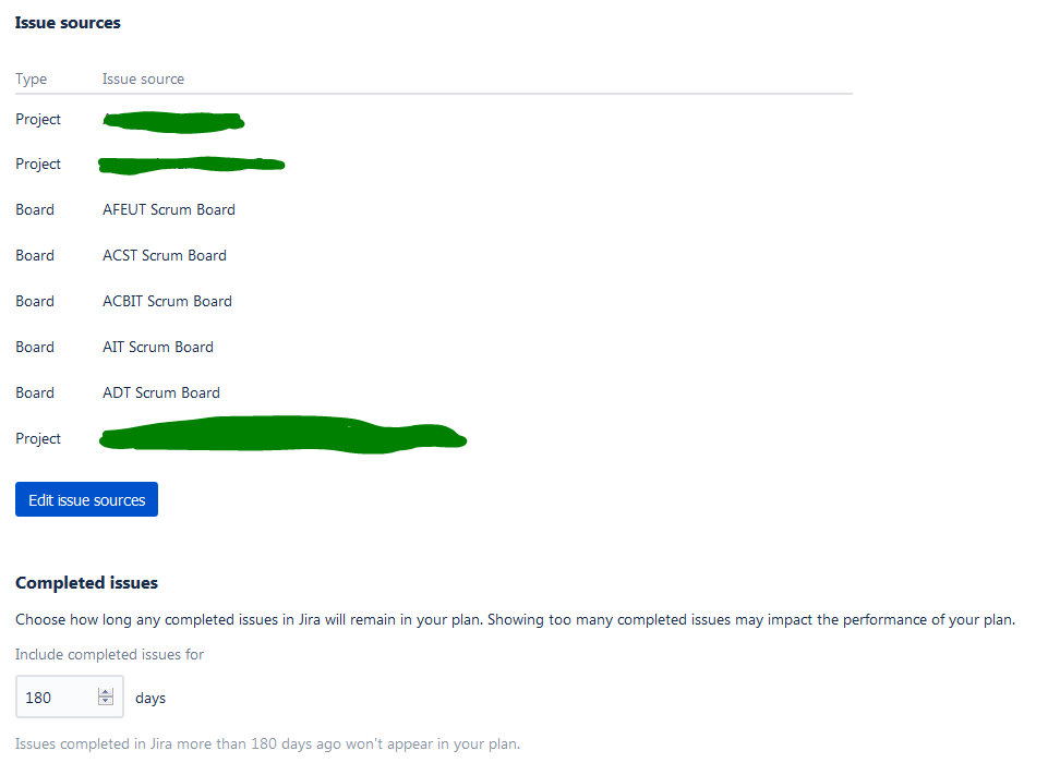

I'm an experienced Portfolio for Jira user, but face an issue that I can't seem to resolve. In my Portfolio Plan I have a set of Projects and Boards that are part of the issues sources. No specific filters are part of the issue sources.
When issues in the planned are moved to Done (Done status) the issue is directly not longer visible in the plan, although I've set the Completed Issues settings to 180 days. Below a screenshot of the settings.
In the plan itself I haven't enabled any filters which also doesn't clarify why issues are filtered out. I'm using Portfolio for Jira version 3.1.0 on Jira Version 7.13.0

I've created a new plan and added the original filters again. This seem to have solved the issue, since the issues have appeared in the plan again...
