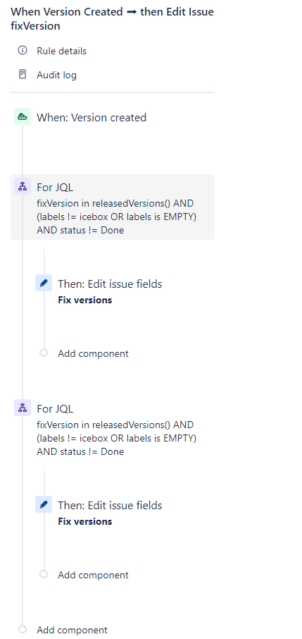

I have set up an automation to update the fixVersion of issues after a release. This rule is triggered by another rule which ends with creating a new fixVersion.
Although the JQL for updating the fixVersion only returns less than 500 issues, I still find up to 50 issues that did not get updated with the new fixVersion.
I have tried to compensate for this by trying the same  action a second time. This reduced the number of issues that were missed, but I still end up with 20 or so issues that are still stuck on the old fixVersion.

By the way: using that branch twice in the rule should not help...I would expect it to worsen the symptom you describe.  The reason is that branches on one-and-only-one issue (e.g. branch to parent, current issue, etc.) get run in-line and so they complete before the rule proceeds with the next step.
But branches that could be on more than one issue (e.g. JQL, linked issues, etc.) get run asynchronously and in parallel.  There is no guarantee they will finish before the next rule step.  And so your issues in those two branches are possibly trying to update the same issues repeatedly.

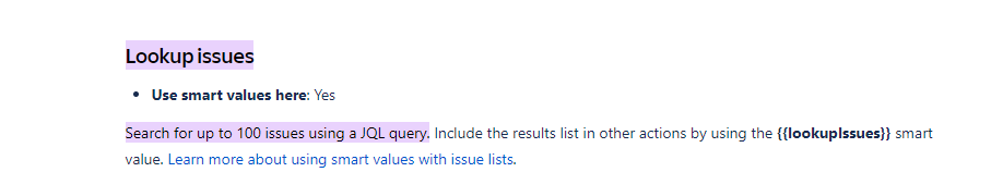

The number of issues that were written in the audit log turned out to be 100 which is way lesser than expected. I expected 308 issues.
I also eliminated the second branch for testing and noticed that 80 issues were left out. Which means 200+ issues got updated which is greater than the number returned from lookup.
Does lookup issues have some sort of limit?
keerthi
January 16, 2023
Looks like the lookup issues function has a limit of 100 unfortunately

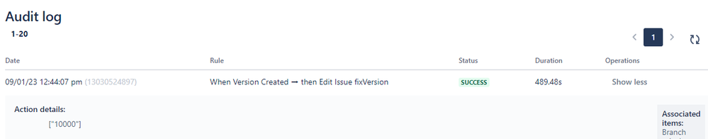

@keerthi Interesting. Are you able to share what the audit log entry says for the most recent run?
keerthi
January 9, 2023
Does that give all the information?
