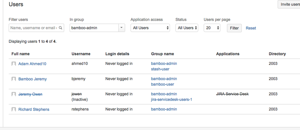

AnnWorley
May 24, 2017
I tested disabling a user ("Jeremy Owen") in AD and he stayed in his LDAP groups,  just marked inactive:Screen Shot 2017-05-24 at 9.19.36 AM.png
Sometimes AD admins will move a user to an OU for disabled users and take them out of any security groups. It doesn't impact your local jira-users group because that one is not controlled by LDAP. When the LDAP admin puts them back in the LDAP groups, JIRA should pick up those memberships again.
If users are being re-enabled and JIRA is not pickinhg up their group memberships it may be worthwhile to open a support ticket so Atlassian can take a closer look. An LDIF export of the user from AD and a support zip will help Support get started.
