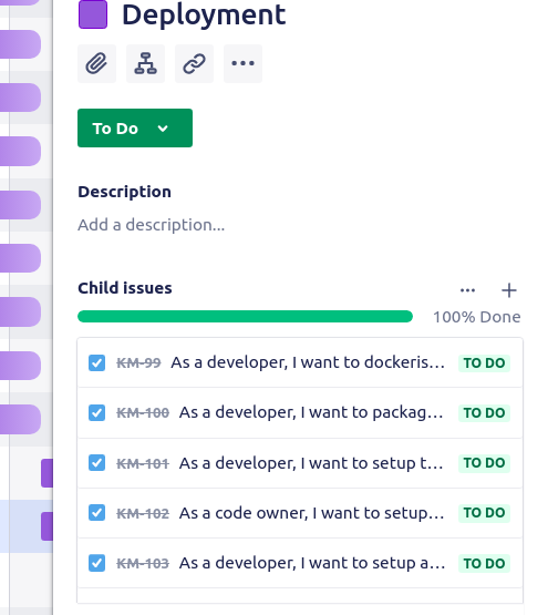

I've attached 2 screen shots:
Both show a list of child issues (tasks) related to a epic called "Deployment".
In the first, you'll see that all child issues are marked 'To do', but the progress bar says that all child issues are j100% complete.

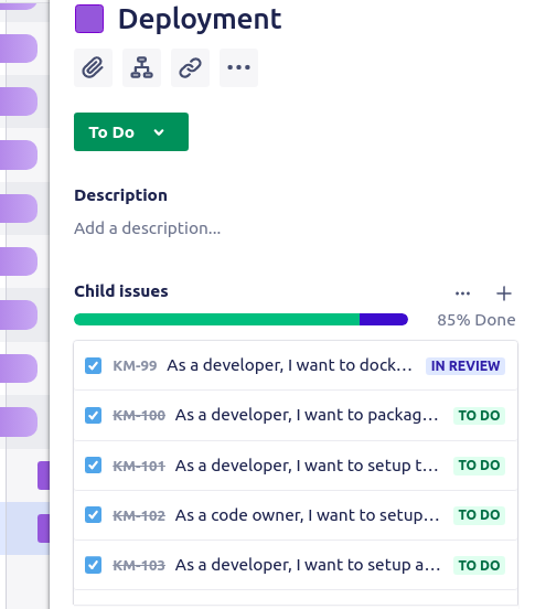

Then in pic 2, I've marked one of the child issues as in review, and then the progress bar moves to 85% complete.

Hi @ryan
Thanks for the screenshots.  It looks like a set up issue, and that your 'done' status is called 'To Do'.  What happens if you mark everything as 'done'?
