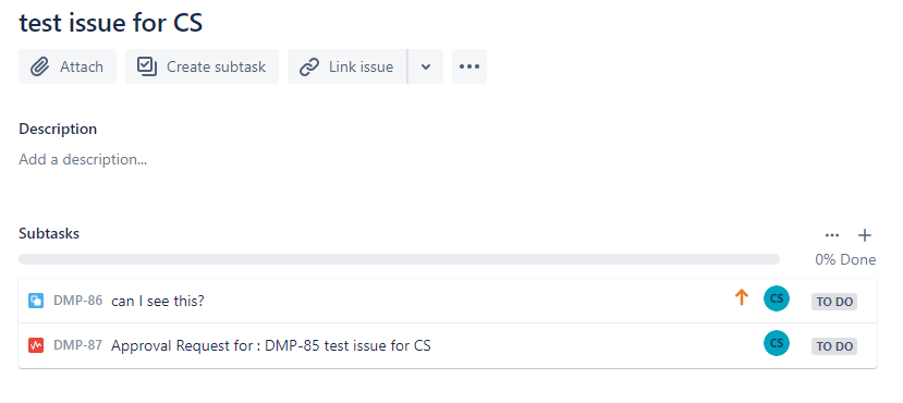

We created a custom sub-task issue type called approval. Then we created a process that creates this sub-task type which is then assigned to a user.  The user however cannot see these specific items under the 'Assigned to me' within the your work area. They also do not appear in the results of the default 'My open issues' filter. I also tried to create a filter just for these sub-task types but that doesn't work.  I have dug pretty deeply into the documentation and didn't find anything either.

Christine Schutta
July 23, 2020

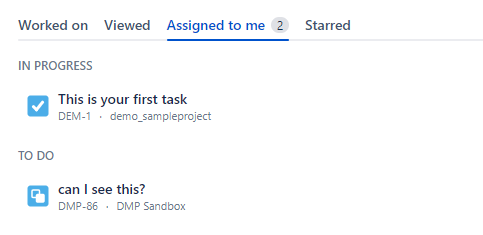

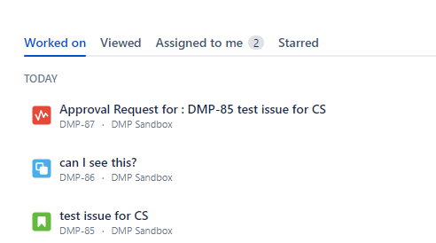

I did create the approval sub task manually on a story. I see it in the story view, in the worked on view but not the assigned to me view.  When I create a default sub-task manually it behaves as expected.

Christine Schutta
July 24, 2020

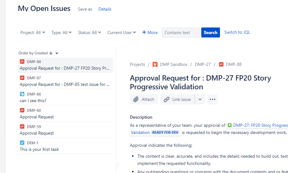

So how do we figure out if it's something we missed or a bug? The approval sub-task is assigned to me and has been since yesterday. It still is not visible in 'you work' or 'my open issues' default filter.

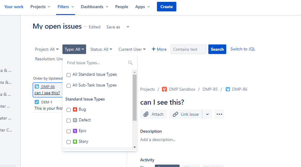

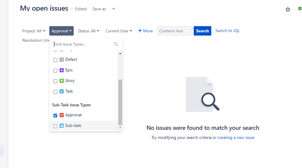

Here is the default My own issues filter and when I try to add 'Approval' - I go from 2 results to 0.

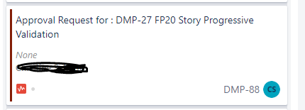

Here is a custom filter I made which shows all issues assigned to me and then just a shot of the actual issue confirming that it is specifically assigned to me.

so to determine if a bug you would need to work w/ Atlassian Support. However, TBH my bet is not on it being a bug. I could certainly be wrong here. The one thing I note from your images, and I'm trying to follow you here, is that the first images use Resolution = unresolved whereas the later one does not. Is it possible that this is impacting results vs. expectations?
