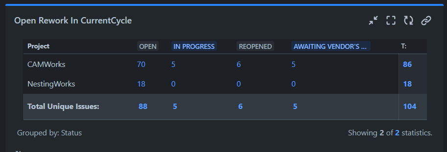

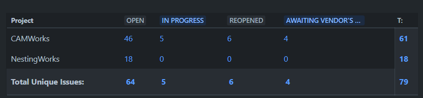

I'm using native JIRA two-dimensional charts Screenshot 2024-09-19 163104.png
The total number of issues here is 79, but when I click on the 79 to see the details
JIRA will open up the saved filter which was used for this chart

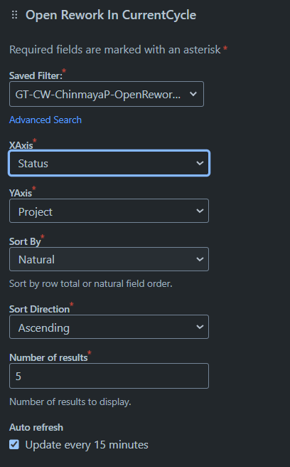

Below shown is the configuration of the chart as shown below.

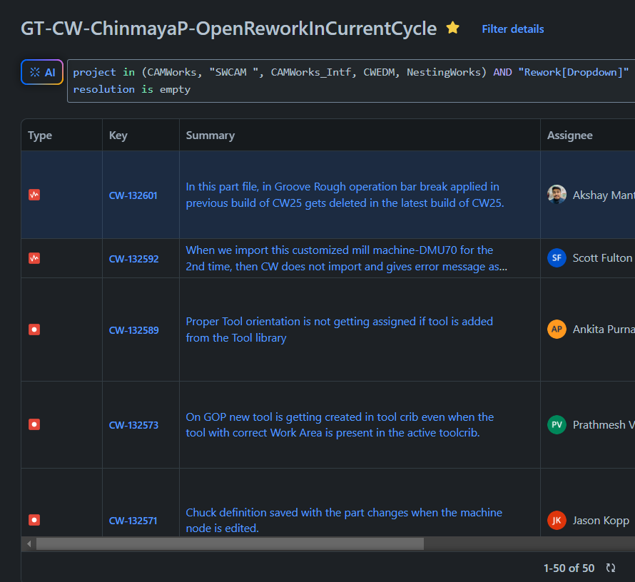

Screenshot 2024-09-19 164326.pngHowever if I execute the saved filter the output is not 79, it's just 50, as shown below.

Intriguing!  Just as John wants below I'd like to see the full filter JQL
What happens if you click on the totals - 61 for CAMworks and 18 for Nesting works => what numbers of tickets will you get when viewing those "subfilters" in issue navigator?

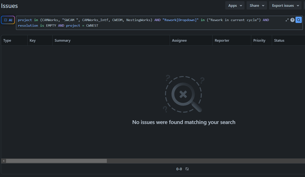

@Lisa Forstberg It used to work properly for many years when we click on 61 for CAMWorks it used to show the correct query with the filter applied
But it has stopped working for the last few months

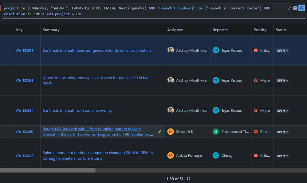

Just for your information below is what I clicked on 61 for CAMWorks
and when I click on 18 for NestingWorks

Seems like you cant see the Nesting works tickets at all and some of the CAMWorks tickets are hidden.  If you go to the nesting works project, are you allowed to browse this project at all? Are there any issue security schemes applied to these projects.
I would however expect that the dashboard gadget would only present those tickets that you have browse permission to.
What kind of field is the "Rework" field? is it a single select or multiselect field?
What happens if you copy the filter and remove the resolution - condition and use the filter in the dashboard? Is it still displaying the wrong numbers?

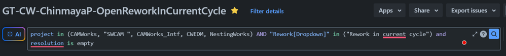

somehow the forum is restricting me from posting the query in text here, so putting the image

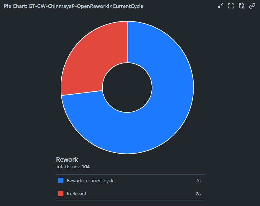

As I get different results for the same filter with different dashboard gadgets
With Jira native Two dimensional filter statistics [Wrong]
With Jira native pie chart [Wrong]

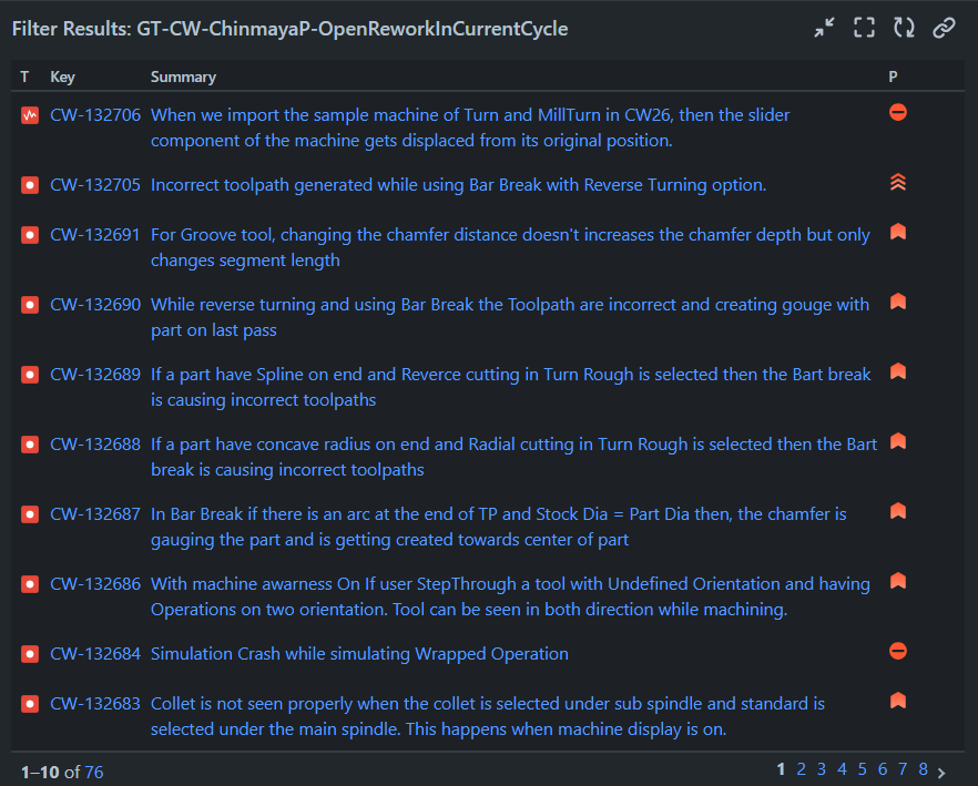

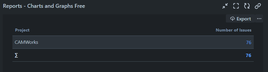

Using addon charts [Correct]

I have shared the actual filter earlier as well unfortunately when I try to put the entire filter here it does not allow me to post so providing the image
