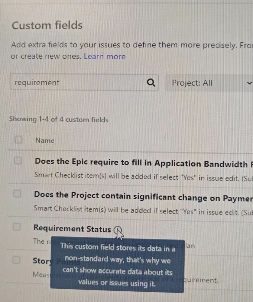

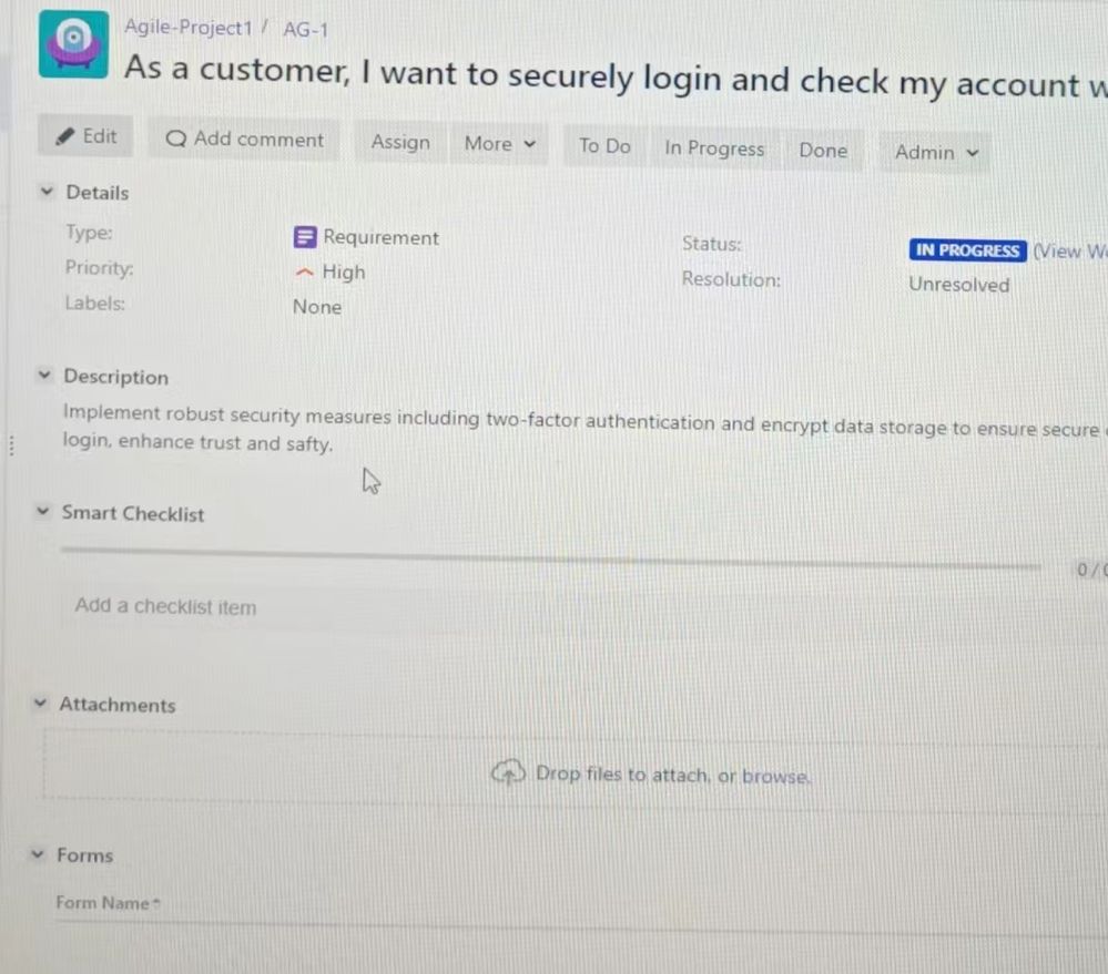

I am use Jira software data center version 8.20.
The custom field "Requirement Status" is not show on the issue screen. Please help fix the problem. Thanks!
Can not find it on the screen

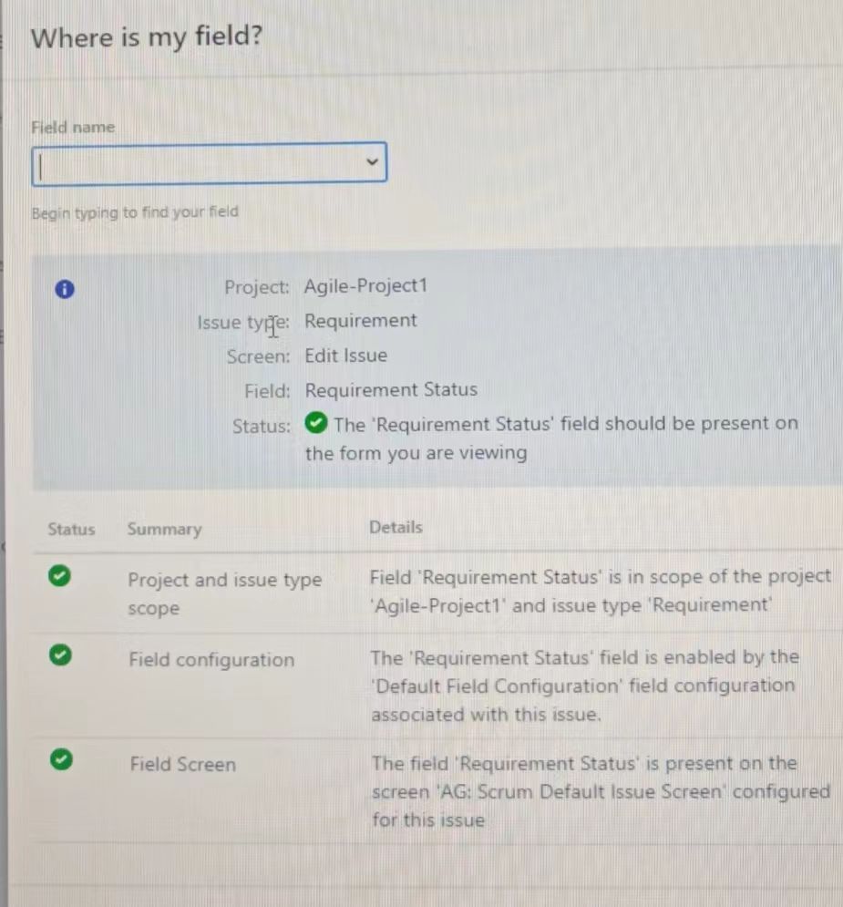

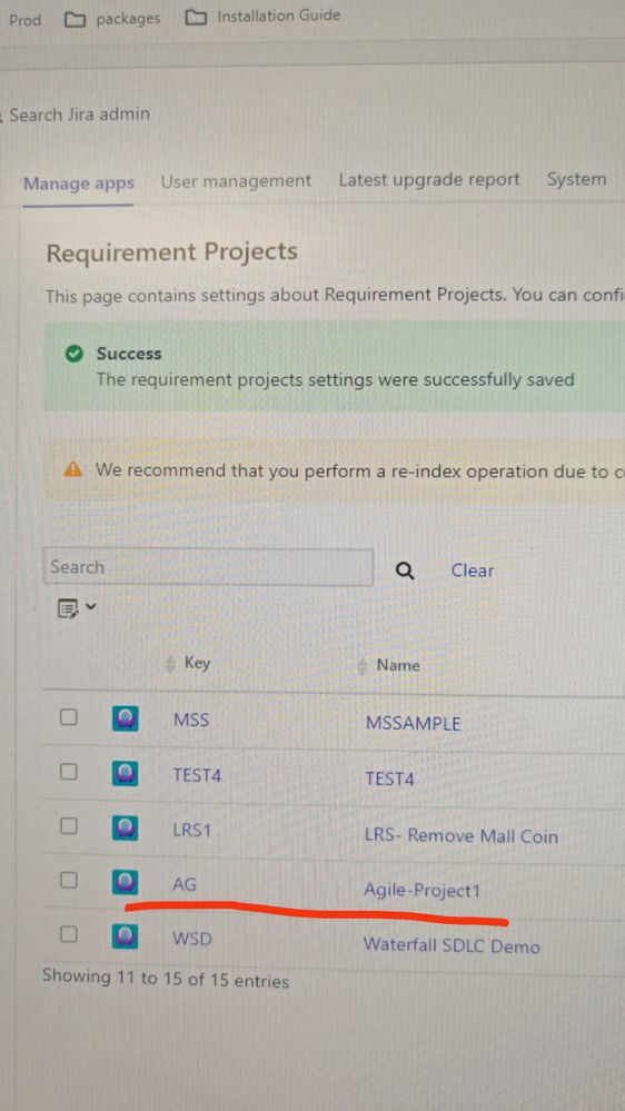

I added it to "Requirement Projects"  and tried create one more requirement ticket.  But still cannot view "Requirement Status" field. Any other clue. Thanks!
Florian Bonniec
May 28, 2024
Hi @Owen
Have you added the project to the Requirement project in the Xray configuration ?
https://docs.getxray.app/display/XRAY31/Requirement+Projects
And added the type to the requirement configuration ?
https://docs.getxray.app/display/XRAY31/Issue+Type+Mapping

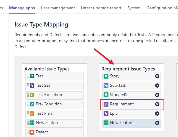

Did you properly configure the Issue Type Mapping section ?
Owen
May 30, 2024

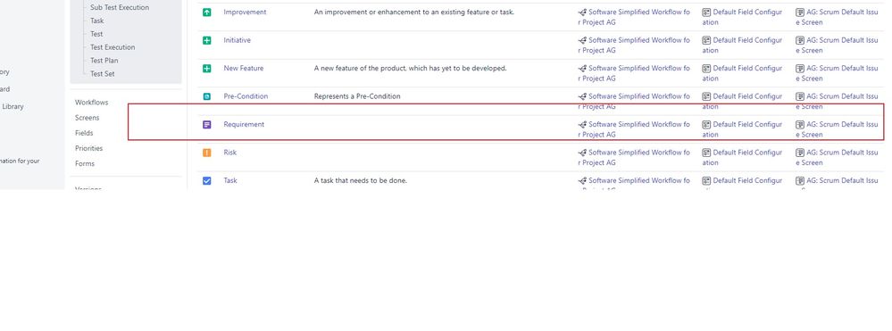

@Florian Bonniec Need special screen or field configuration?  Thanks!
Owen
May 31, 2024
@Florian Bonniec
It was fixed after I add "Requirement" to "Requirement Issue Types".
Thank you for your help!
