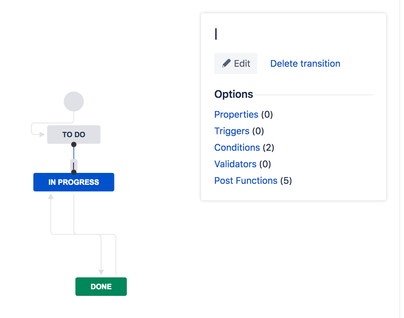

Additionally, can you please send a screenshot of your workflow displaying what you get when you click on a transition?
To add Validators, Conditions and Post functions to a Workflow transition, you must first click to Edit your workflow - The advanced options are not allowed on the view display.
Better explaining:
- Navigate to JIRA Settings > Issues > Workflows
- Find your workflow and click to edit it
- On Diagram view, click on the transitions you would like to add validators, post functions or conditions and a panel should open with these options:
Let me know if this information helps.

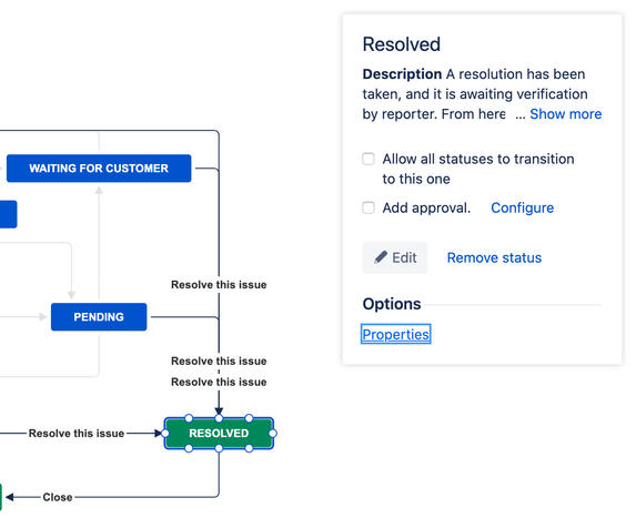

I'm using Jira SD Cloud on a paid license and I can't see most of those, particularly I need Validators to setup a Workflow and it just doesn't exist.
Chris Shaffer
May 7, 2020
NVM I realized when I looked at your screenshot vs. mine I was actually clicking on the status name, rather than the line/arrow for the Transition.
It would be very helpful if this was clarified in the Jira documentation.

Chris Shaffer
May 7, 2020
I understand it's mentioned, however it's not obvious that "transition" means the little line with an arrow.
A screenshot would have been quite helpful.
