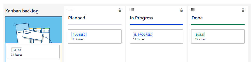

Orestis Fainekos
January 10, 2018
Thank you all for your answers!
Independently of the aspect of usefulness, I have found why I can't see in-progress issues. The reason relates to the workflow I use. I have both backlog and todo states in our workflow and it seems that the UI backlog is implemented to show only the next transition state of the backlog. So, I guess that this is the reason I only see the todo state in the screen similar to Jack's

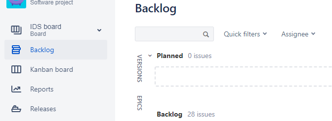

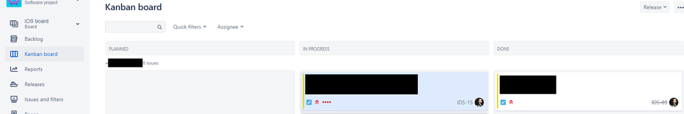

Jeremy Schraufnagel
October 12, 2018
I actually just ran into this similar issue as well.  The problem is the kanban board just shows the next status transition, as @Orestis Fainekos mentioned previously.  As you can see in the attached screenshots below, we have Planned and In Progress statues, but only the Planned status issues will show on the Backlog and not also the In Progress issues.

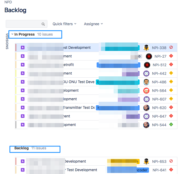

Jack Brickey
January 8, 2018
on Cloud...
I don't use the Kanban Backlog feature much but just the other day I turned this on for a project using the "To Do" column for the backlog. I was a bit perplexed to find on the Backlog board that the "In Progress" actually showed there. There are two sections "In Progress" and "Backlog" each collapsable.
So I agree w/ Nic that there would seem to be no reason to have In Progress on the Backlog board since it show on the Kanban board. But it is there at least for me.
