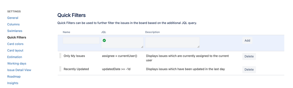

Are you specifically referring to the filter option in the board's setting?
If so, I've attached it below.
Thank you!
Esther Strom
March 23, 2023
Hi, @Ryan Seeras - as @Nic Brough -Adaptavist- mentioned, that is the Quick Filter setup. These are the quick filters:

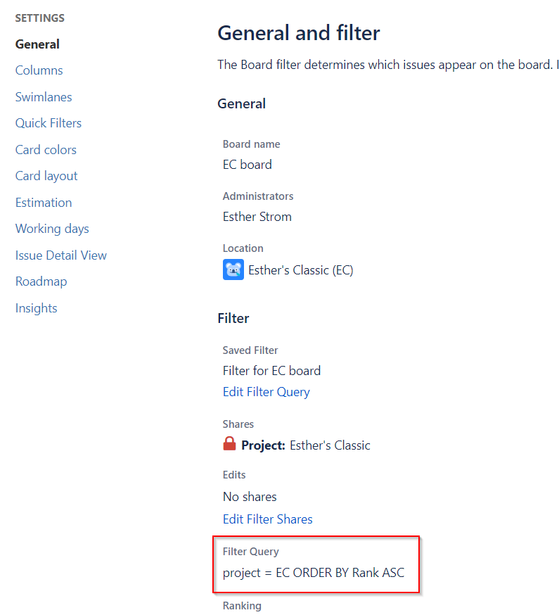

We're looking for the board filter. Click on General in that Settings list to the left, and scroll down to this area:

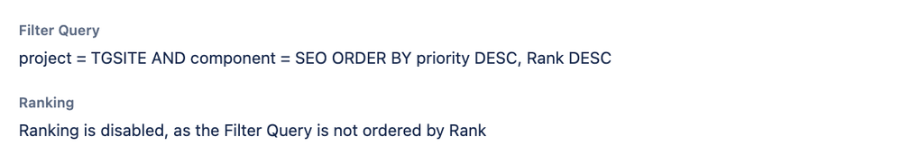

Below is the Filter Query: Screenshot 2023-03-23 at 10.30.13 AM.png
Below is the status column section. We do have a "Wont do" section under unmapped status but the issues that I'm creating fall under every other column (e.g., To Do, In Progress, Blocked, QA, etc). Yet, they don't get populated in the Active Sprint board.   Screenshot 2023-03-23 at 10.33.08 AM.png

@Ryan Seeras so your filter query is excluding any ticket that doesn't have the SEO component from your board. Are you selecting that component value on the tickets you're creating?
Like # people like this
Ryan Seeras
March 27, 2023
Yep, this answers it.
I've never used a board that had filters/components like this so I was unaware of how it all worked.
I was able to change the filter and I'm no longer having this issue.

What is the board filter?  Is it possible that your new issues are not being selected by the board?  Also, how are the status mapped into columns?
March 22, 2023
Those are the quick filters, not the board filter.
We need to know what the board filter is - have a look at the "general" section of the board config.
We also need to know if you have all your status mapped into columns, that's in the "columns" page.
