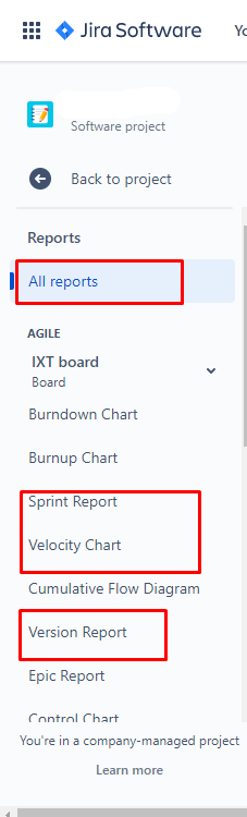

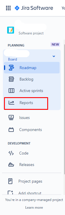

Raviraj Suryavanshi
January 13, 2022
@Pratik Acharya
If you are using Scrum board and you have required access then you can find reports as below.
Please validate if the Jira admin has provided access to you
Pramodh M
January 13, 2022
@Raviraj Suryavanshi the query is referring to team-managed project reports and screenshots you have given is company managed project reports
