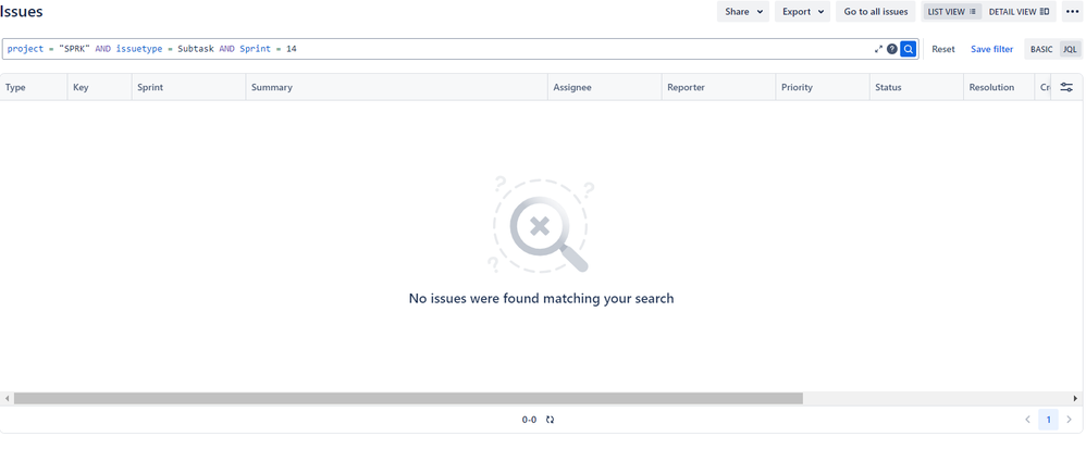

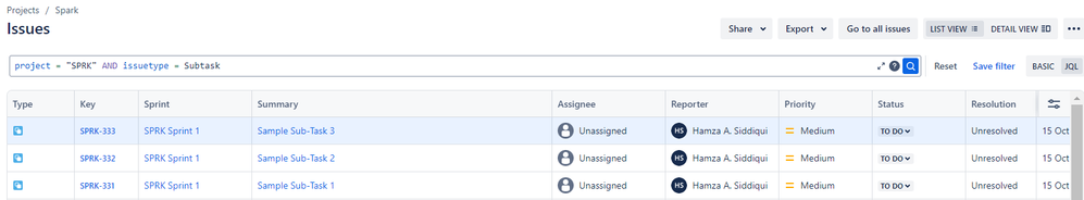

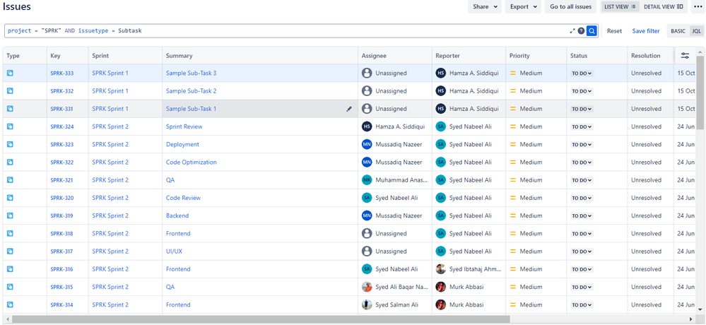

I am trying to filter the data based on the query (screenshot attached). In query as depicted, My project is selected but there are no issues filters based on Sprint. What could be the issue here? This is occurring only on sub-tasks as issue type. Please refer screenshots for better clarity.
Please note that Sprint Id 14 is SPRK Sprint 2.
Please help why is it not filtering data based on sprints and issue type = subtask
Screenshot 2024-10-15 164318.pngScreenshot 2024-10-15 164432.pngScreenshot 2024-10-15 164523.png

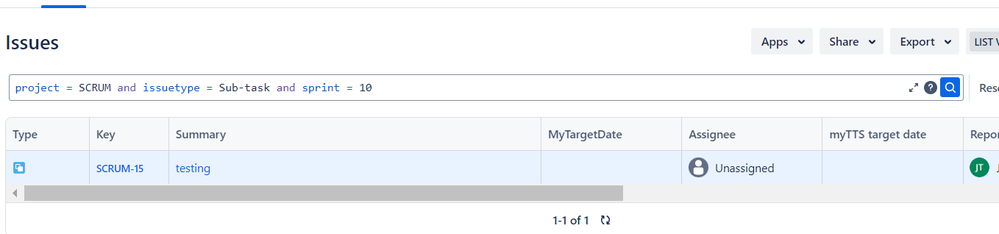

The issue you have is with the Issue Type name.
While you can use "Subtask" what you need is to filter by "Sub-task"
You can also do the following:
sprint = 10 and issuetype in (Subtask, Sub-task)
Thank you.

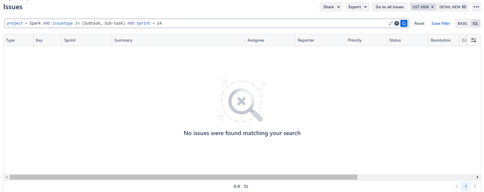

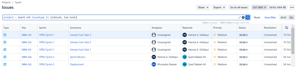

I did the same but adding the sprint in query won't retrieve the results. What's the issue then?

Hi @Hamza A. Siddiqui ,
Thank you for your update. I hope you're doing well.
From the latest screenshot, I see that you are now targeting a different project, your latest screenshot shows
project  = Spark
But on your first screenshots, you mentioned that this sub-task is under "SPRK" project, not "Spark"
Please double-check and confirm.

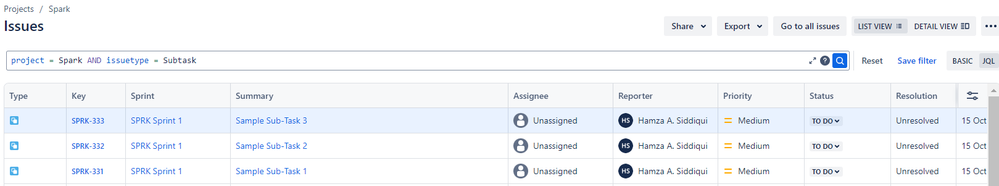

Thanks for quick response, the project name mentioned in both screenshots are same they results in similar results.
Please see below for reference.

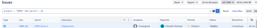

Can you access the issue SPRK-325? I think you can as it is shown on your first screenshots.
So you have access to that one.
Then, it's either a different type, not Subtask or Sub-task.
Now, I've reviewed your screenshot that shows SPRK-325 and indeed that is not a sub-task.
The icon that it shows under "Type" it's the icon for Tasks.

Hi @Hector Florin
I wanted to follow up regarding the icons shown in the screenshots above; they appear to be related to subtasks. It seems there may be an internal issue preventing me from fetching my subtasks using the sprint parameter.
I’m currently exploring alternative approaches to meet my search criteria.
Thank you for your assistance.
welcome to the community!
It's been raised recently that for sub-tasks from team-managed projects, JQL searches based on sprints don't seem to work. This looks like a bug to me, and should probably be raised with Atlassian.
Is SPRK a team-managed project?
It's worth noting that sub-tasks are a bit special, in that they always "inherit" the sprint from their parent issue. I could imagine that our bug is somehow related to this this special behaviour.

Hamza A. Siddiqui
October 17, 2024
Hi @Hannes Obweger - JXL for Jira ,
Thank you for your response. I confirmed that my project, 'SPRK,' is a team-managed project, so it seems this may be a bug that needs to be addressed by Atlassian.
I appreciate your suggested approach and will explore it, along with other alternatives, to get my work done.
Thanks again for your help!
