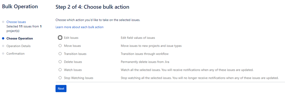

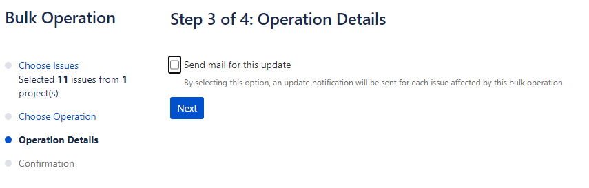

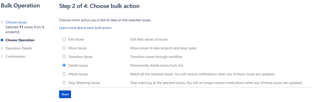

I'm trying to do a bulk delete of subtasks, however I'm unable to complete it.
I'm able to choose issues, choose operation (Delete Issues), proceed to Operation Details , however when clicking Next here, the page simply goes back to the Choose Operation step without any error message.
The screenshots below show the process:
1 Bulk Operation - Jira.png2 Bulk Operation - Jira.png3 Bulk Operation - Jira.png
Any idea why it's not working, or how I can figure out why?

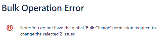

I tried a bulk edit to details on the sub-tasks and I got through to the Confirmation step, and then this error, so maybe this permission is needed for Delete too?
Jack Brickey
January 3, 2023
Yes. I suspect that you do not have permissions to make bulks changes. This is configured under admin > system > global permissions. Your Jira admin must change this.
Jonny McAlister
January 3, 2023
Thanks for all the help, Jack.
I got this sorted with our Jira admin, I just needed the Bulk Change permission added.
