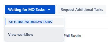

I also noticed that:
1) The statuses in which the transition was missing from the drop-down are those that occur after the transition that goes to the status triggered an automation that creates a sub-task.
2) In addition to the missing Withdraw transition, a Request Additional Tasks transition (from Any to itself) is missing.

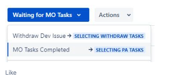

Status in which both transitions appear:
Status in which both transitions are missing, after sub-task was created by automation triggered by the transition that goes to the status:

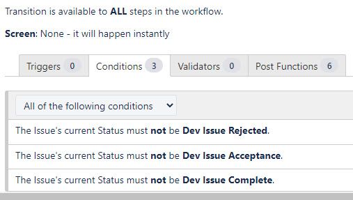

Withdraw transition conditions--these do not affect the status shown above:

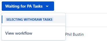

- for each of the above two items show the Conditions in the workflow transition between the issue's current status (Waiting for PA Tasks?) and the specified destination Status.

The only reason I showed the transition conditions was to show that there were none involving the statuses in question.  These conditions are working.

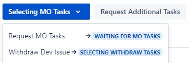

As shown below, in the Selecting MO Tasks user view, the "Withdraw Dev Issue" transition button is shown paired with its target status in the status drop-down:

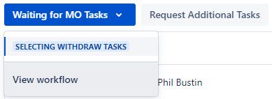

When the user clicks Request MO Tasks > Waiting for MO Tasks, and the status changes to Waiting for MO Tasks, transition "Withdraw Dev Issue", is not displayed; only its target status, "Selecting Withdraw Tasks", is displayed.

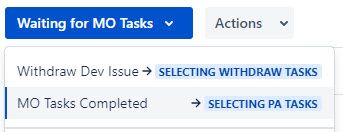

When I assign myself to an Administrators group in order to be able to view the afore-mentioned transition hidden by a condition, or if I remove the condition that hides that transition, I am able to see the "Withdraw Dev Issue" transition.  Note that non-Admin users will still not be able to see the transition in the drop-down.

When an issue is in Status A, and all the available Statuses to which it can change traverse Global Transitions (ANY --> destination status), then the drop down will show only the destination status names. That is what you see here.
When an issue is in Status A, and one or more of the available Statuses to which it can change traverses a non-Global Transition, then you will see the Transition Name and Destination Status for all available status options. That is what you see here.
