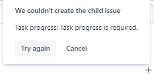

We couldn't create the child issue.
task progress: Task progress is required.
Try again/cancel

Hi,
Company managed team. There are no workflow validators that prevent me from creating a child issue.
We experience this globally - across all types of workflows for projects, when adding as child issue and not linking. Evene in an instance when we try and create a very new story/subtask that is the child of an Epic, same issue.
Looking at your screenshot, it seems to me that 'Task progress' is a custom field made required by the Field Configuration linked to that issue type. Can you check this?
This fixed it! Thank you!
We made it "optional" instead of "required"

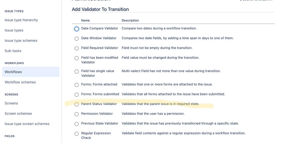

Hi @Krishantha , Would it be possible to see a screenshot of this? Do you happen to have any add-ons that might be involved here? On the surface, this does not look like a native Jira behavior.
Thanks @Krishantha . Please check your workflow for a validator on the create link of type shown below. I suspect this may be the reason you're seeing that error.
