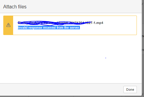

Hi,
I am trying to upload a mp4 file whose size is 248 MB .
it will upload till 100% and then fails with :
"Invalid response received from the server"

Ah sorry, I thought he was referring to not being able to upload an image to Answers, our old site, but this is in Jira. My apologies.
I would recommend you have a look at this article for the resolution:
It's a setting you'll need to change on your server itself so you may need to speak to the server administrator if that's not you.

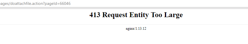

Nic Brough -Adaptavist-
April 18, 2018
That url looks like a Confluence url, not Lithium, so I suspect the question is about Confluence really.
The error message from nginx is helpful - it's not configured or built to handle files as large as the one you are trying to upload.

April 18, 2018
@Nic Brough -Adaptavist-, nice catch!
The original title was throwing me off as well since it mentioned Answers.
The resolution I sent mentions updating the limit in NGINX or Apache itself, which you can try, but as Nic mentioned it might simply be too large for your server.
