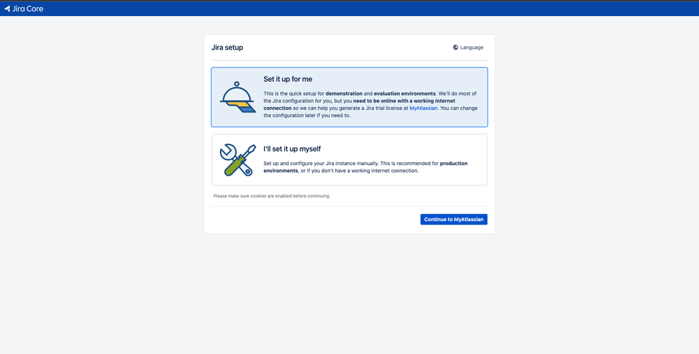

When I go to the home directory, which I believe is the default home directory and also what I set to be my home directory in my script (/var/atlassian/application-data/jira) this is what's there:
caches cluster.properties log plugins tmp
Obviously my script adds the cluster.properties file after the install.
The first node works (I believe?),  I can access the Jira set-up page: Screen Shot 2022-11-03 at 1.41.04 PM.png
Nic Brough -Adaptavist-
November 3, 2022
Ok, so you have not finished setting up the first node, that explains why the directories are empty.
