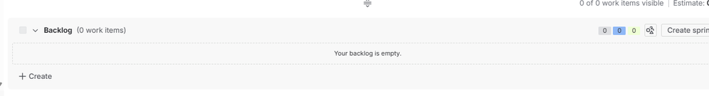

Stories with Backlog status have disappeared from the Backlog view, even though no filters are active. The stories are still visible in the List view with the correct Backlog status, but they don't appear in the Backlog navigation. What could cause this?

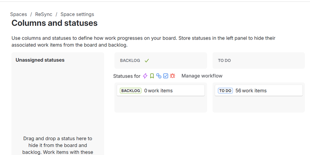

Check the configuration of the board.
Is the backlog option still enabled and the status mapped to the backlog, for company managed space, or is the status mapped to the backlog on Team managed space?

It's Team-Managed space and the status is mapped to the backlog. The interesting part here is that under the Backlog it's also showing 0 work items backlog.png

Resolved!
The issue was in the Workflow configuration, the Backlog status had its category set to "Done" instead of "To Do".
Not sure how or when this changed, but switching the category back to "To Do" fixed everything.
