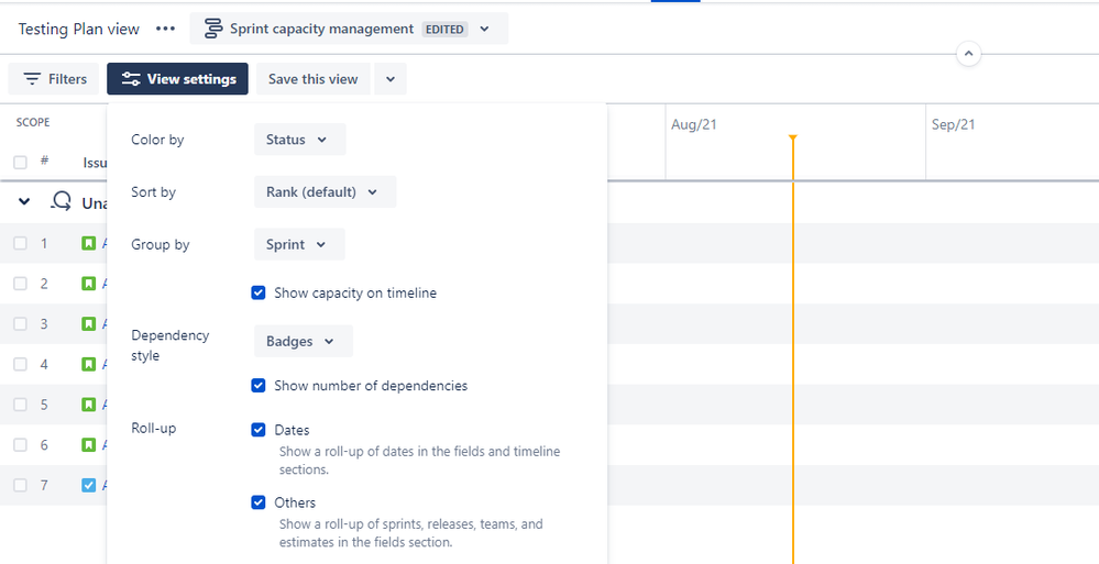

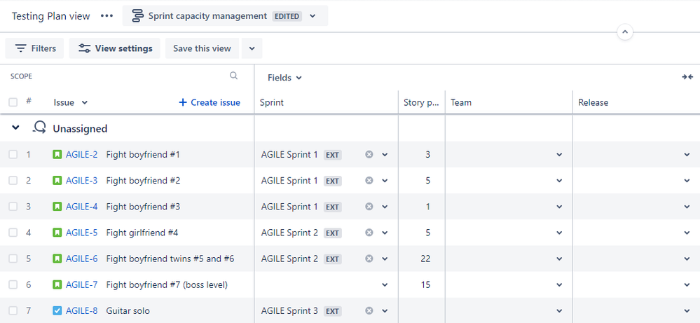

While watching the tutorial for Advanced Roadmaps, the timeline / plan was aggregated on a Sprint Level, along with the dates. See Image 1. But when trying it out, it is not possible to show the Sprints in the plan, only as a column / field. See Image 2.
I am using Jira Cloud. Maybe this is not available for cloud, only for server?
Image 1

Showing capacity in the timeline
  1. In the roadmap view of the plan, click View settings.
  2. From the 'Group by' menu, choose Team or Sprint.
  3. Select the Show capacity on timeline checkbox. This will display the sprints and iterations associated to the teams in the plan in individual swimlanes.

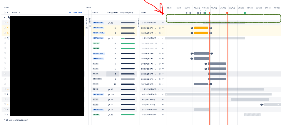

I'm having a similar problem - no sprints shown in the timeline, and that feature would be very useful to us.
I have selected to group by Sprints, enabled Show capacity on timeline, and am using the Sprint Capacity view. AS you can see in the screenshots though, no sprints on the timeline.
Reading through the linked KB pages suggested above did not provide the fix. Please suggest my next steps?  Thanks

Navigate to Plans > my view > dropdown off view type > Manage views > Issue sources.
Set the issue source to use the Scrum board where you have created the sprints you wish to see because sprints belong to Scrum boards, not Projects.

Chris Deutschmann
September 3, 2021
I have same issue and @Dave F  your suggestion didn't work unfortunately.
Any other ideas?

ronald.miranda
January 20, 2022
I could make it work by creating a Team in the plan, then you should create your stories under this team and you will see the sprints in the timeline,

Dave F
January 20, 2022
@ronald.miranda has found the trick. It seems that even after configuring the Plan with boards that have sprints, the sprints from the board do not appear until you assign a team to a task on that board.
Kenneth Woo
December 7, 2023
I just want to see sprints on the timeline when I select Group By: Project. Then it will be very useful. Why Group By: Team to display sprints only? I don't understand.
