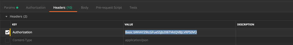

With using Postman, all you need do is in the Headers tab, create a `Authorization` header with value `Basic encodedusername:apikey` e.g.
