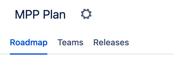

   I got to know from this article that there is the "Dependencies report" in the advanced roadmap, which looks very useful to my projects, but I cannot see this tab in my plan.
Is it because I don't have the required privilege or is it related to a lower version?
Thanks
Xingcai

Hi @Xingcai Gu
Just in case this is still an Issue for you, it is most likely an access/settings issue.
You'll need to be a Jira Admin to check/change the following settings - if you are not one, I recommend contacting your internal support team for assistance.
The instructions also differ between Cloud and Server/DC - I've provided both options below.
Cloud
  1. Go to Plans (on top navigation bar) > Settings
  2. Select Advanced Roadmaps Permissions from the left-hand menu
  3. Ensure there are Groups assigned to the LABS Access permission
Note: You also need to be in one of these Groups. You can check Group membership in your User Management Settings
Server/DC
First, check the Permissions:
  1. Go to Plans (on top navigation bar) > Administration
  3. Ensure there are Groups assigned to the Advanced Roadmaps early access permission
Next, check what early access features are turned on:
  1. Select Advanced Roadmaps early access features from the left-hand menu
  2. Ensure the Dependencies Map checkbox is checked
Let us know if this helps resolve your issue!
Ste
