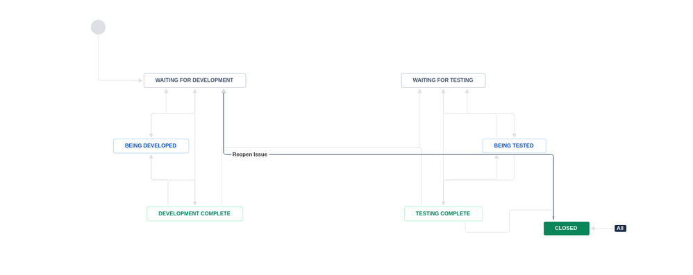

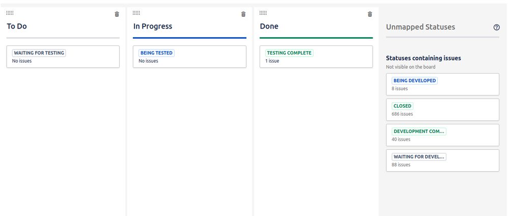

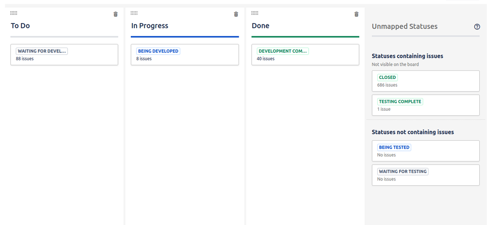

Right, 'Closed' isn't mapped to any board.  There are two boards, one for development and one for QA.  The workflow spans both boards.

Ok so the observed behavior is certainly due to the boards configurations. If you move an issue from Closed back to the development board it will be see as sprint churn and increment the count. There are a couple of thoughts I will share here FWIW but keep in mind they are only my opinion based upon my experience w/ agile and the tool.
  • by breaking your workflow across two boards the sprint burndown and agile approach are really not going to work well as designed
  • if you need to separate QA from Dev then I would recommend not using the same issue spanning both boards.
  • I would suggest using different issues for QA, i.e. "develop feat1" is the development issue and "test feat1" is the testing of the issue. If QA finds a bug they open a bug and it goes in the To Do status into Backlog. You can use different issuetypes if it help keep them separated.
  • Simplify the workflow: To Do, In Progress, Done rather than having specific verbiage.
  • Avoid reopening issues once Closed. I'm not a fan of reopening issues. Opening a new issue is cleaner. Going back to To Do from In Progress is fine but if an issue is closed it should be final. Again, just an opinion.
BTW, I attempted something very similar to you years ago and in the end really regretted it.
