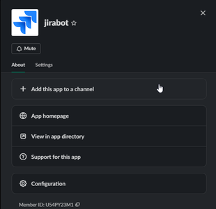

Chris Buzon
August 11, 2021

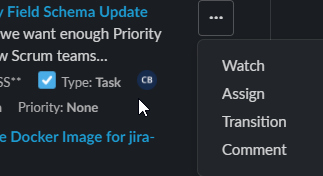

Yes, there is an integration called Jirabot (Or Jira Cloud if you Add a new App in slack)- your slack admin may need to add it. Once it's installed you can hook it up to different projects and move/preview different jira tickets.  There are other slack apps like Jira+ that can do quite a few things as well, but I don't know exactly what you're looking to try to do - so you may need to experiment with a few.
I should also clarify - if you want to update an already-sent slack message with up to date info, I don't think that exists. You'll likely have to set up a notification system with jira automation that sends a new message when status changes occur.
