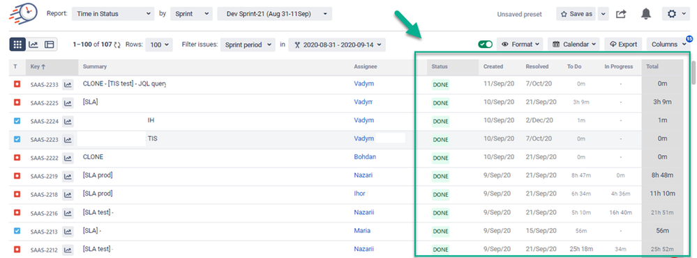

The easiest way to track how long it takes to solve an issue, in my opinion, is to try Time in Status for Jira Cloud.  It generates the Time in Status report, which shows how long an issue has been spent in each status. In the " Total" column you can see the cumulative sum of time spent on the issue.

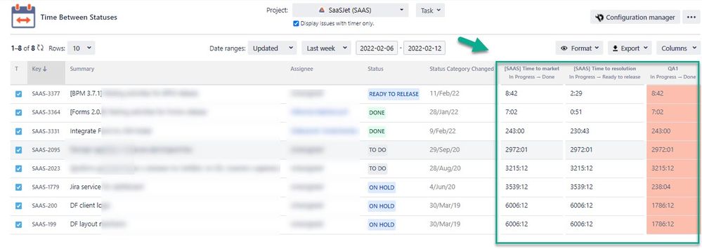

To track how long it takes an issue to move from one status to another you can try Time between Statuses. All you need is to create Status Groups for the time between "Issue Created" and "In progress" statuses.
These add-ons are developed by my team and are free for using up to 10 users. So let me know if you have any questions.

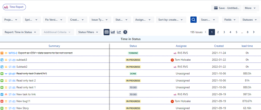

Hi @Andrey Rudnev

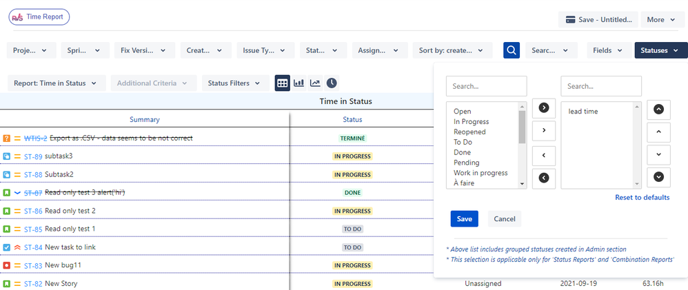

For creating a Status Group, pls navigate to Settings - Apps page. You will find Time in Status -> Grouped Statuses link on left nav bar.
After creating a status group, on "TIS - Time Reports" screen, please select the group name from the "Statuses" drop down as shown below. Click on "Save" in the pop up.
In the example below I have selected the "Lead Time" status group.
You will see "Lead Time" as a column in the results table.
Hope it helps.
Pls let me know for any further query.
Thanks
Rahul

@Rahul_RVS Great, that really helped. I created a group of two statuses: In Progress and On Hold. I added this group according to your example, now I see the total time for these statuses. Such a question, can I see ALL the time using the created group, for ALL tasks, and not separately for each?
Rahul_RVS
Atlassian Partner
February 21, 2022
Hi @Andrey Rudnev
This feature is in our backlog, ie total for time in each status for all the issues, and we will be implementing it soon.
However as a workaround, you can easily export the report to a CSV file and total up the time for each column.
