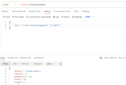

When using the POST /rest/api/3/search api, you need to add backslashes to the double quotes, else the tool will assume those as the quotes used during the API call, adding a screenshot below of how I use it in Postman :

I just noticed that you used the below in your body (as per the main query):
 {jql: "id in (1,2,3)"}
you will have to put the key in double quotes, correct query is as below :
    "jql": "id in (1,2,3)"
