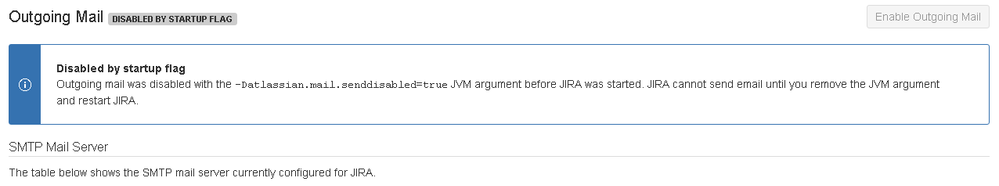

I only know the answer to part of your question.  You're able to turn mail on or off from the JIRA Admin Console on the following page:  Admin > System > Outgoing Mail.  Additionally, and more useful in your scenario, you can set a flag in a config file.
There's some more info about this method here: https://community.atlassian.com/t5/JIRA-questions/JIRA-QUEUE-Warning-Sending-mail-is-disabled/qaq-p/165247 and here: https://confluence.atlassian.com/adminjiraserver073/setting-properties-and-options-on-startup-861253969.html  (Look for the string: "Mail property")
Important: Make sure there's no trailing space at the end of the flag!
Here's a screenshot of how it looks in the UI when mail is disabled with this method.
